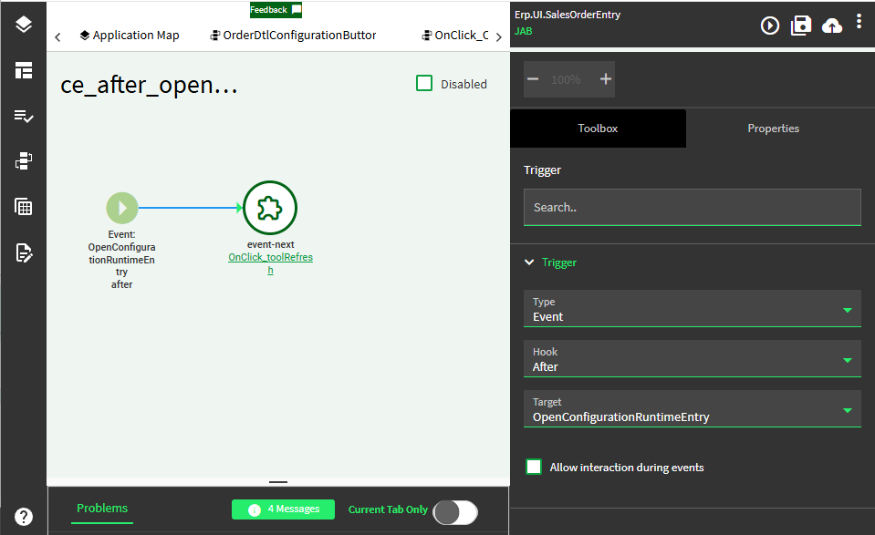

If not, then it’s not refreshing and maybe it’s your version. You could try adding an event triggered after_OpenConfigurationRuntimeEntry with event-next: OnClick_toolRefresh action.
I’m on 2024 so maybe it just was not fixed yet. I do not see those no.
That is the solution I came up with for now as well, unfortunately it just means the user is always one line behind, as it will refresh after they press configure, but that will only update any previous lines, not the one it is now launching for.
