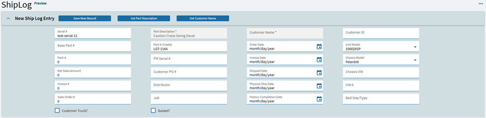

Basically, the user goes to a Create Page and fills out some fields on a form.
The fields get automatically added to a temporary DataView whose purpose is to hold a single row, the row to be saved to the database. The DataView is created using the same BAQ as the landing page with the grid and form. The temp DataView is never populated with data until the user clicks away after entering a field.
For example, the user enters the Serial # as test-serial-11, then clicks empty page space, then test-serial-11 is automatically saved to the DataView.

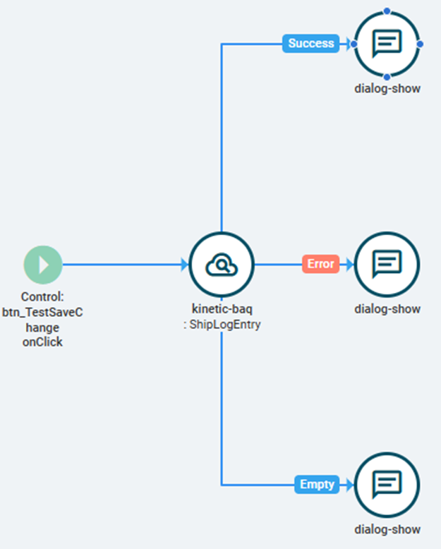

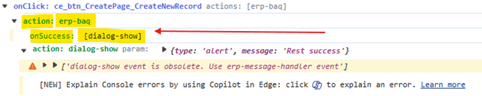

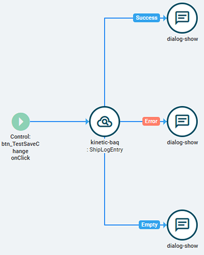

After the user fills out some fields, the user hits a Save Button. Upon click, the event below is triggered.

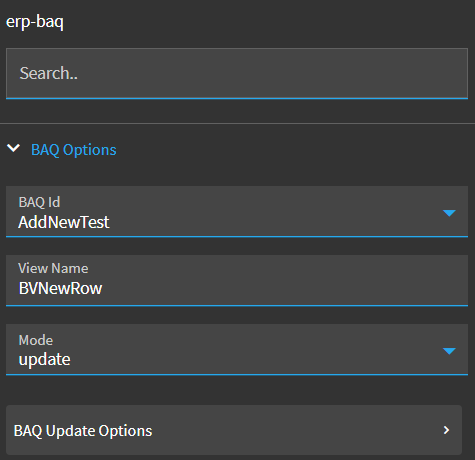

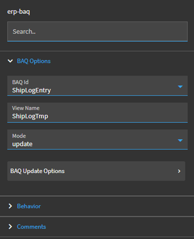

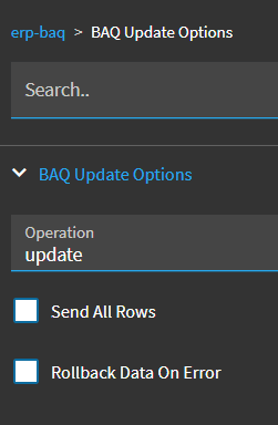

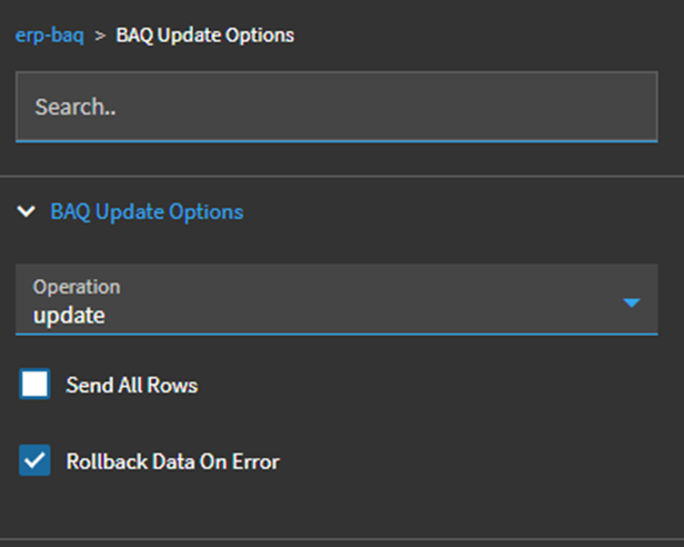

I want to load the single row from the temporary DataView into the kinetic-baq, and save it to the database. The rest call parameters are below.
BAQ Options
BAQ Options >> BAQ Update Options

The Rest call comes back as successful. But no new record is created.

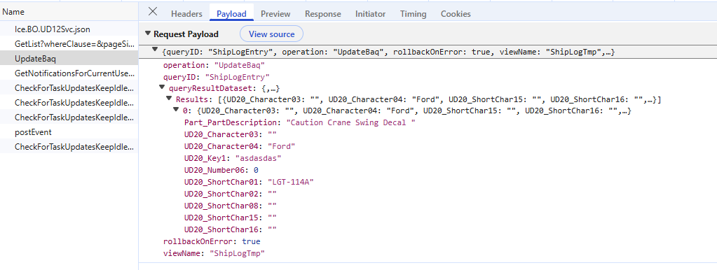

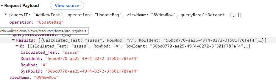

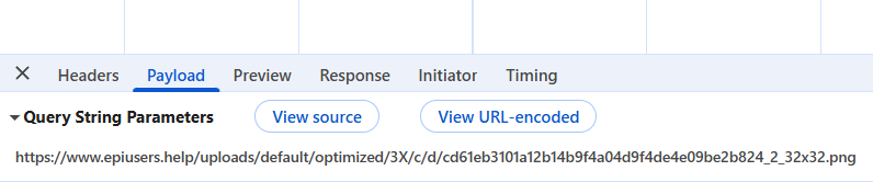

Take a look at the actual rest call to execute BAQ and look at the payload.
What do you mean by that? In the browser with developer options?

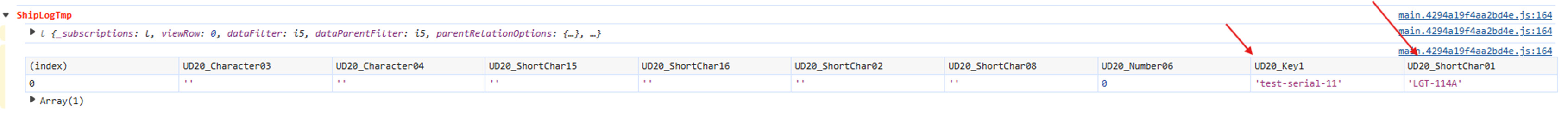

In the browser, it looks like its coming across as all empty fields?
Is this what you meant by look at the payload?
The correct fields/values are in the Payload.
Don’t see RowMod in there.

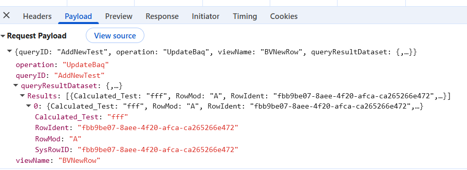

Does RowMod need to be set to U ?
It should probably exist at all, and should be A
I just set this up and it worked for me.

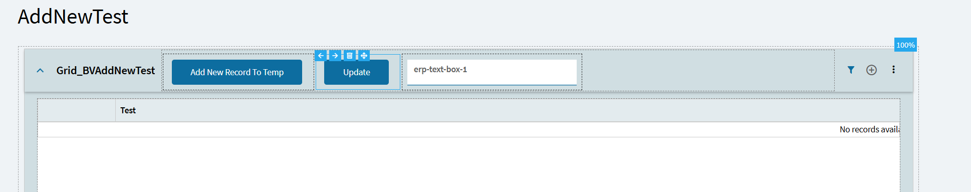

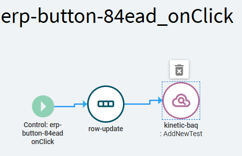

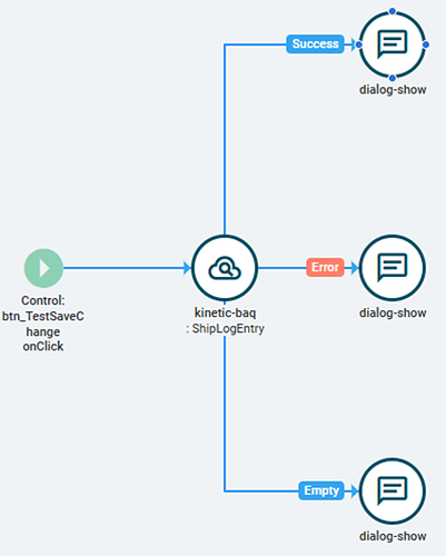

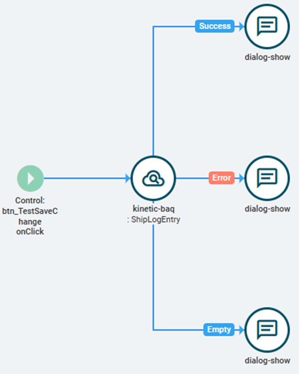

I noticed in your pictures above, they both have the same control trigger.
Did you post the same picture twice, or is that a mistake?
Also, if you reuse that same row, instead of blowing it out and adding a new, you will need to use a row-update to set the RowMod to ‘A’
It exists, even if you can’t see it.

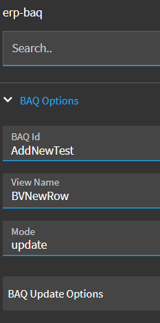

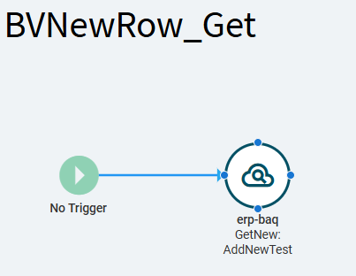

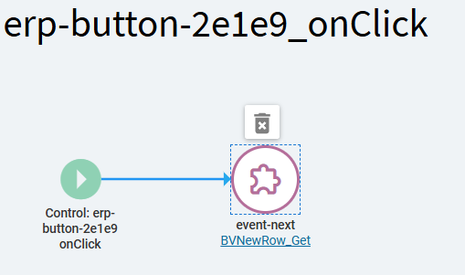

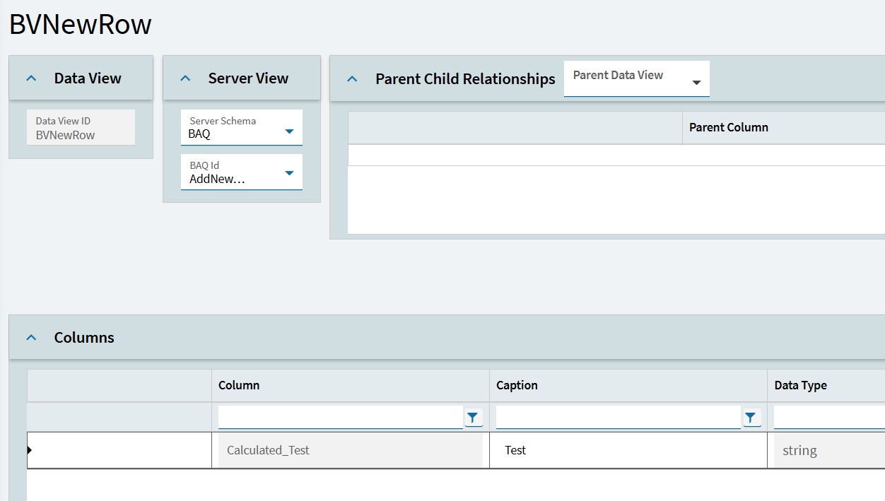

Could you show your setup? For example, the event workflow and rest params?
I appreciate this so much.
Temp Dataview: BVNewRow
Button Add New Record To Temp
BVNewRow_Get
Button Update
To clarify, the first time it will already be ‘A’ from the GetNew call, and will work, but subsequent calls will not because it will be reset from the Update call.
So either blow out the row, and add another, (which will blow out your data lol), or just use row-update to set the RowMod.
