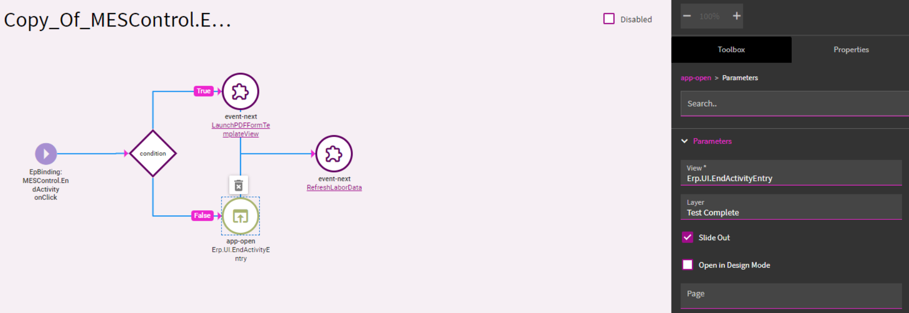

What I am attempting to do is modify the MES screen and End Activity Entry. I need to modify the button for end activity to open the custom layer for End Activity Entry. I have created the copy of the locked onclick event and modified like so…
This only seems to open the correct version sometimes. On end activity entry I am adding another checkbox for incomplete and attempting to remove the rules attached to complete. Therefor making them select incomplete or complete to save/click ok. The end goal of all this is to make it so it opens end activity, they select complete or incomplete, and end their activity. The problem is people are not completing operations when they are completed (typically happens when they are under quantity). They are used to it autofilling complete which is part of what I’m removing.

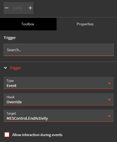

In your event properties, you need to update the trigger to override the original event. Hope this helps!
Yes! That is exactly what I was missing. Thank you!
