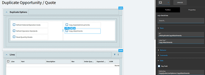

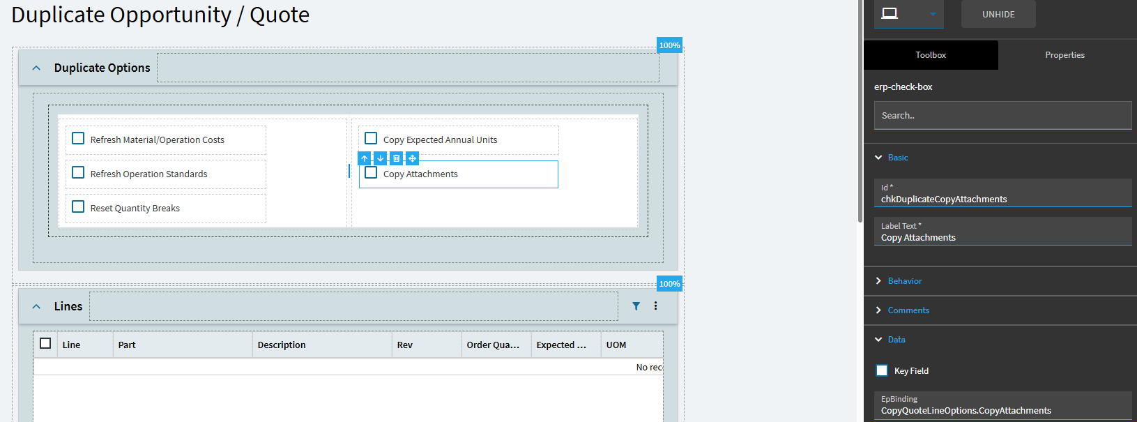

In 2025.2, I am editing the quote entry application, and I am trying to make the Duplicate quote slide out checkbox “Copy Attachments” to be empty when the slide out is opened. Here is the value that I am attempting to change:

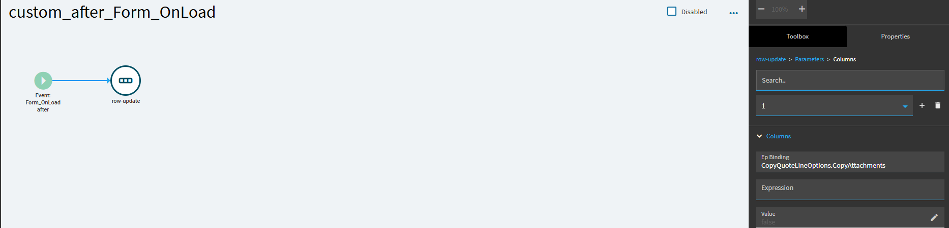

I have tried a few things to do this. First I made an after on load event to do a row update on CopyQuoteLineOptions.CopyAttachments and set the value to be false. This did not work, so I tried a before on load event and that did not work either.
Then, I searched for ‘duplicate’ in the event search to see if there was something related to the duplicate quote feature, and I found “OnClick_toolQuoteHedDuplicate”. I made a before and after event for this event in the same style as the onload event, but neither worked. What am I doing wrong? My guess is that I am not putting in the correct EpBinding, but I have no idea what else to put in.

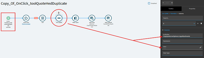

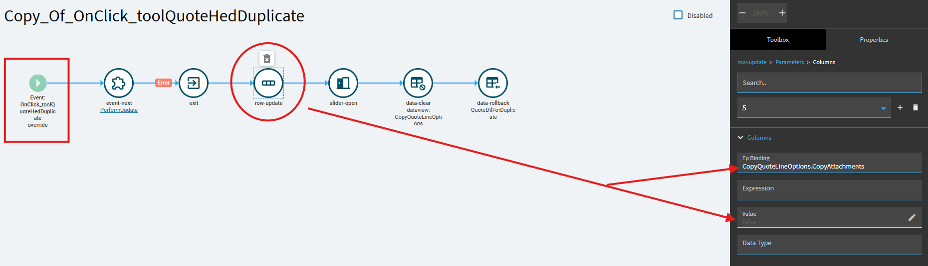

Instead, you can Copy the existing OnClick_toolQuoteHedDuplicate event
Set the trigger to override the base event…
Then update the row-update widget within the event to set “CopyAttachments” to false.
This approach worked for me.
This worked perfectly, thanks for the help!
