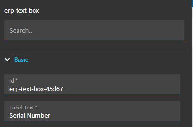

I’ve created a Case Entry Kinetic Layer. In the Layer under the related information section, I’ve created a new Serial Number text box.
In this box I want to prepopulate it with the serial number, which for us is Sales Order + Line + Release.
I know the data I need to populate is
(HDCase.OrderNum - HDCase.OrderLine - HDCase.OrderRelNum)
How do I do this in Application Studio?
