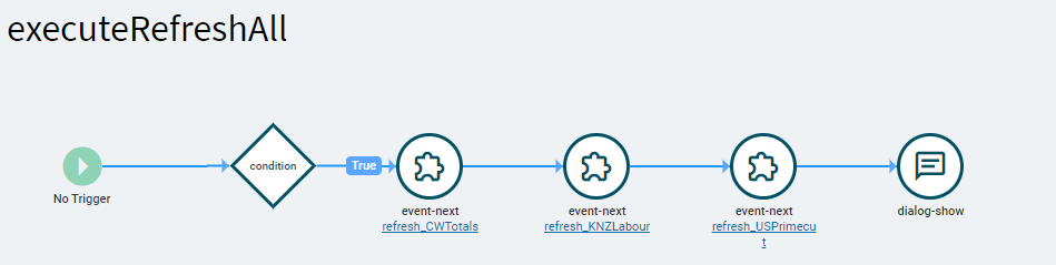

When I look at the event logic created, there’s just 4 events:
(the dialog show here is my addition to make sure its firing, but i know it is as the BAQ for the main query has query params, and I get the slideout to enter these (a date range) )

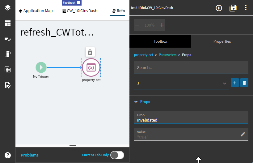

Each of the refresh_xxxx events is just setting an Invalidated property to “true”:
No idea how this actually triggers the BAQ gets… I expected to see some baq gets in the events, these are buried deeper under the hood and inaccessible/hidden maybe.
