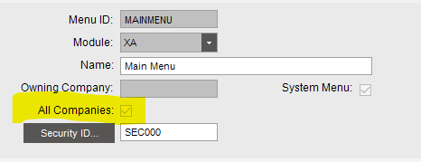

10.2.600.9 - I have a customization on the Opportunity/Quote Form with all companies checked. User security has all rights checked. When I go into Menu Maintenance to Opportunity/Quote entry customization does not show
I have seen similar threads on this but nothing recently. Anyone else seeing this in Pilot on SaaS?
Check that the below matches the Customization. If you think they do match, change the one on menu maintenance and then try the Customization dropdown.
Thanks but it won’t let me change anything. All it shows for the Quote Form is All Companies checked as is the customization and the Owning company is blank on both the menu and the customization
