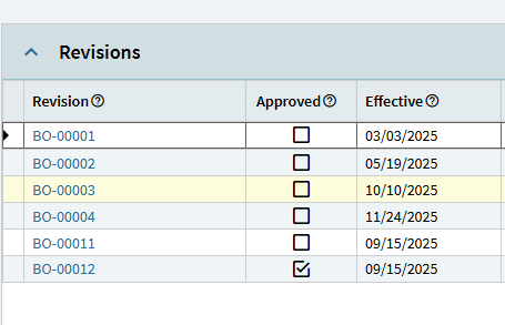

What does your revision screen show for the part mentioned in the error (6710055/3)?
BO-00011 did not work for it either. Made a same MOM via Get Details for BO-00012 and then it works. I also checked advanced planning and it is all there. Planning set is visible also for 6710055/3. I am gettin a feeling that some process does not work for the failing revisions.

I did make a ticket, but after carefully going through all MOM levels and checking all effective dates on all revisions there were no more errors on Quick Job Entry nor MRP. I don’t know for sure what was the issue. Seems awfully that some date was not available for some parts and therefor nothing happened. Now MRP creates suggestions for all 7 levels of parts with correct dates and revisions.
