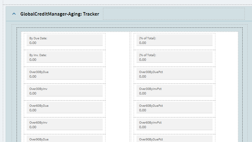

Kinetic gives me this nice little tracker:

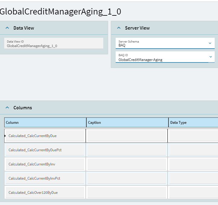

With everything bound up correctly to this nice little dataview:

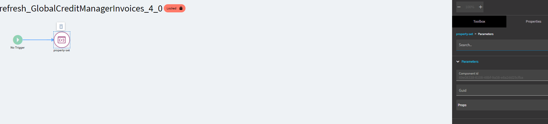

But, for whatever reason, it fails to create a “Refresh” event for this one particular dataview on its own. All of the other ones in this dashboard were wired up correctly by the conversion:

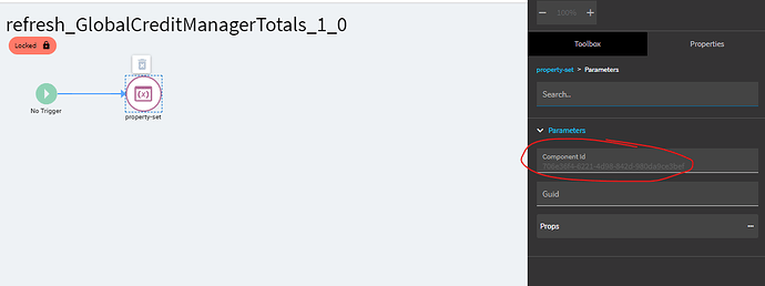

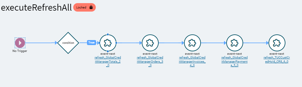

I can follow Hannah’s guide to create my own version of “Refresh all” but what I don’t understand is how these native refresh events themselves work. They all set the “Invalidated” property to “true” for some Component ID:
I don’t understand what those component IDs are, or how to make app studio refresh my dataview.

The component ID is the ID of your control, in this case the grid. You will find it under Properties > Basic. If that grid is bound to a Provider Model, invalidating the grid tells the Provider Model to refresh. That’s my understanding of it.
