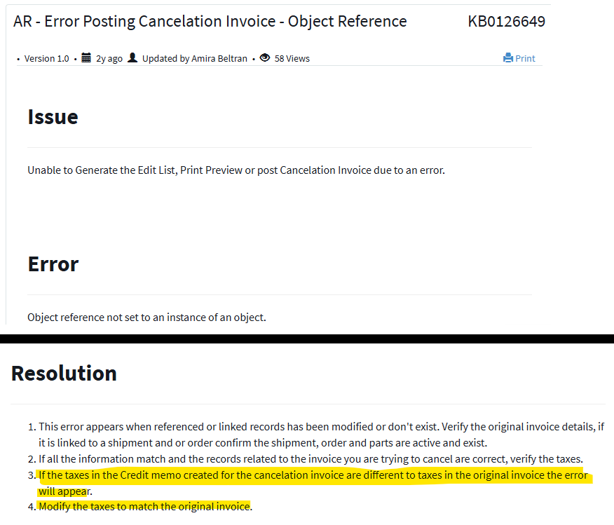

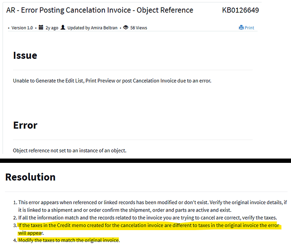

KB0126649 explains the problem and solution very well, I think.
Well that’s great, but why is the error still “Object reference not set to an instance of an object”???
I considered complaining to support, but I know where that would go, so I skipped the runaround and went straight to making an Idea to put the answer in the UI, not just on EpicCare. https://epicor.ideas.aha.io/ideas/KIN-I-5767
