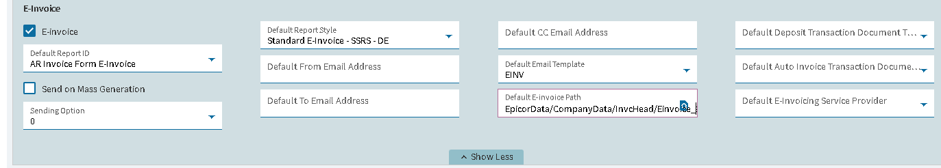

you need to change the slashes in this field from backslashes ‘\’ to forward slashes ‘/’.
Company Configuration, Click the Modules button, navigate to Finance. Then on the Accounts Receivable card, expand to Show More.

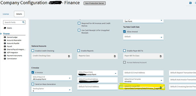

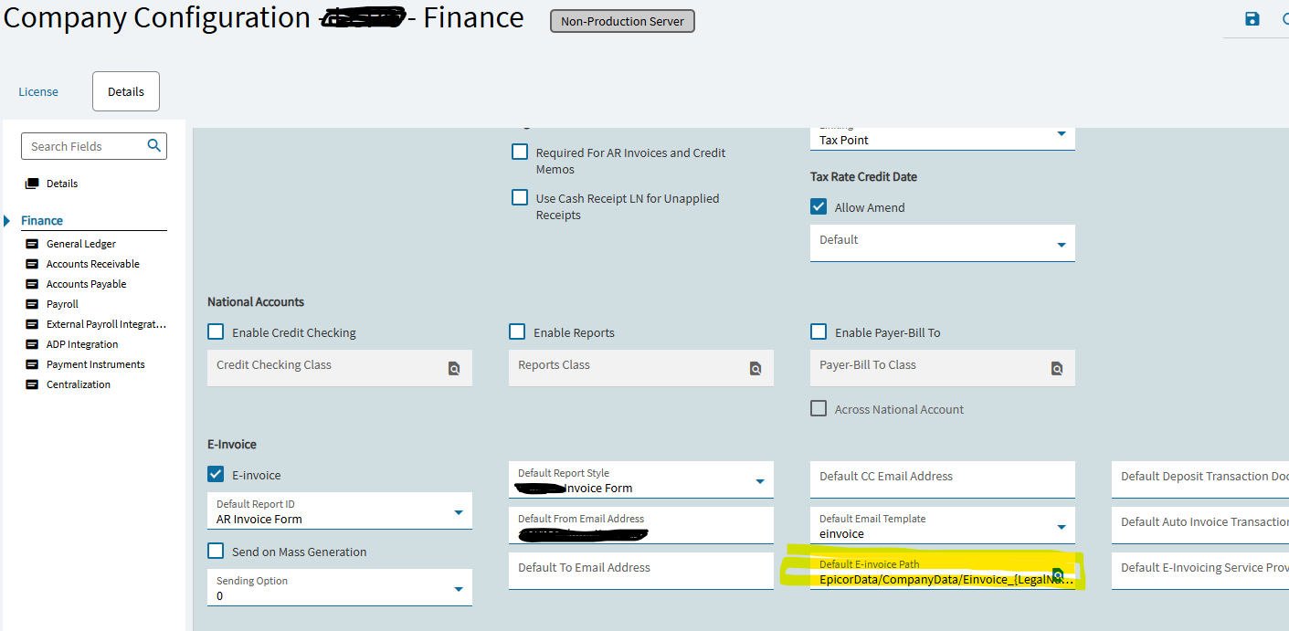

that’s not the correct place, as far as I know. You have to go to the Finance Module in Company Configuration, then the Accounts Receivable Card, then expand to Show More and the find the Default E-Invoice Path field and change the slashes there.
That is one of the areas the path was corrected in:
hmmm… that’s the only place I changed the slashes when I was trying to fix my E-Invoices that generated and didn’t send.
Sorry I don’t have anything further to show you.
