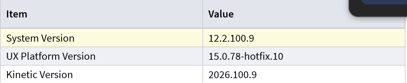

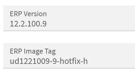

We upgraded to 2026.100.9 and the latest hotfix:
We are no longer having the issue.

We’re on the same vesion, but still having issues with the function…
It is still not working for us either. This includes updating Pilot to 2026.104.
