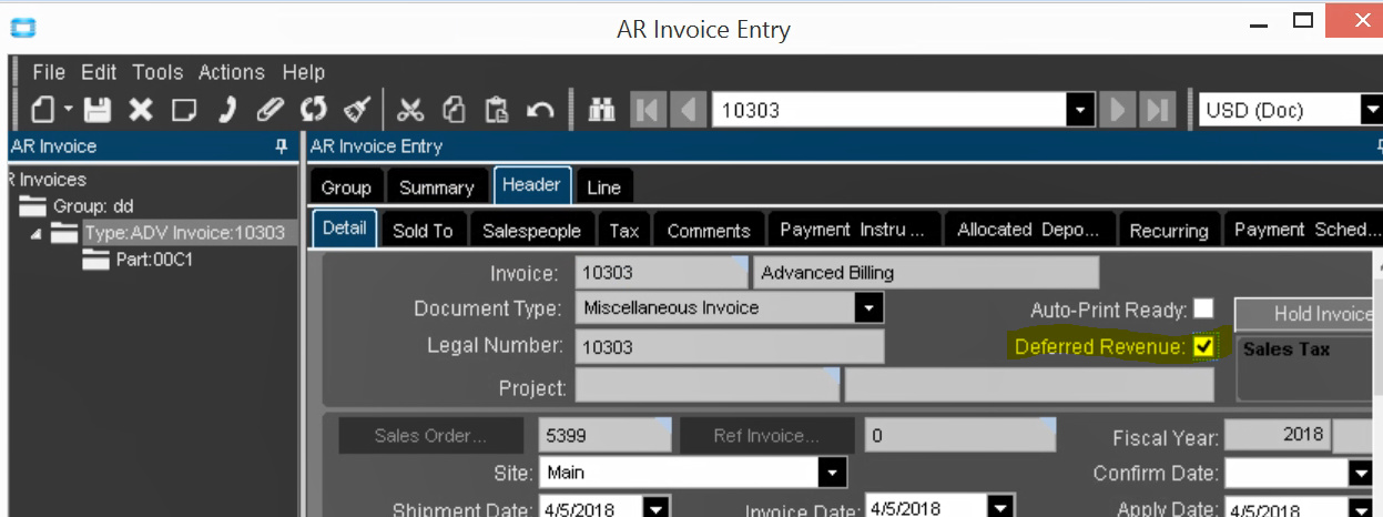

Advanced billing invoices will hit deferred revenue account if you click the deferred revenue checkbox located on the header.
<div class="post-metadata">
**Author:** ![Dora](https://www.epiusers.help/user_avatar/www.epiusers.help/dora/32/960_2.png) [@Dora](https://www.epiusers.help/u/Dora)\
**Post date:** [April 5, 2018, 7:51pm UTC](https://www.epiusers.help/t/ar-entry-less-advanced-billed/43818/11 "2018-04-05T19:51:56Z")
</div>
![image](https://epiusers.help/uploads/default/original/2X/f/f68816342507011eb749cc0970782ff42fdafeb4.jpg)

We’re seeing advanced billed on Shipment invoices that are not hitting the deferred revenue GL account.

@cchang, I think Dora is saying the Advanced Shipment invoice **can** be made to hit the deferred revenue account if that checkbox is selected. The checkbox is interactive ONLY for this type of invoice.
According to the help text for that field, the subsequent Shipment invoice will hit the Sales account. The checkbox for Deferred Revenue cannot be modified.
