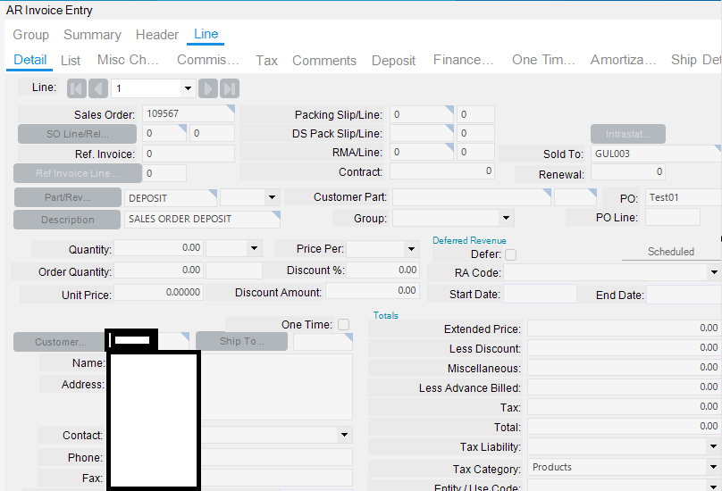

I am looking to setup the Deposit Billing in our Kinetic system, but it is not allowing in add a NEW LINE, only a misc line.
What am I missing?

No need for a line, just go to the Deposit Tab (At the line menus) you should be able to enter your amounts and description for the deposit.
