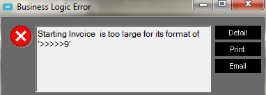

For many years one of our companies in Italy has been changing their starting invoice number at the beginning of every year (Government Regulation). They simply go to Company Configuration and update the starting AR Invoice Number. We went to do it this year and it seems that Epicor has changed the schema to make the max this field can hold be 6 digits (999,999) and our current Invoice Number is 7 digits (1,700,713). We get the error “Starting Invoice is too large for its format of ‘>>>>>9’” if we try to change it to 1800001. It doesn’t work if we just set it to 180001 because that number is lower than our current so it doesn’t use it.
I have tried doing a updateable BAQ on the ERP.ARSyst table and it also will not let us go higher than 6 digits. What I did do on our test system was modify the ERP.ARSyst table via a SQL statement run in the SSMS. This seems to work on my test system, but I am worried that there will be unforeseen consequences of updating this table manually and not using the business objects.
Has anybody had to do this before or any insight into how safe it would be to just manually update it? I am in a pinch since thy need to start invoicing.

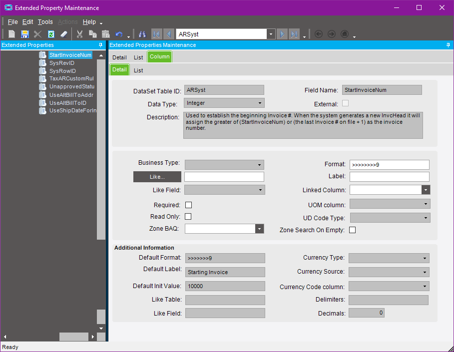

Well Epicor got back to me with a possible fix. Which is to update the format of ARSyst.StartInvoiceNumber via the extended property maintenance. Going to test that out and see if it works.
Just an FYI…
The format change seems to work on a test system.
Note that I also ran a db regen
and increased the size of the mask on the field, company cofig entry form.
Friday… had some time to kill.
I tested it by just changing the format field in to " >>>>>>>>9" in extended property maintenance, saving. Then restarted IIS.
The steps Epicor gave me didn’t say to do a db regen. Not sure if that’s needed, as it worked without it.

Did you enter >>>>>>>9 into the empty Format box? The default is greyed out (which already has >>>>>>>9, so it should work!).

I put it in the empty format box

Jason - Thanks! That worked great. Company Config accepted the new num, and it was there for our next invoice. I entered Case CS0001135010 w/ Epicor as well, so it can be fixed by default.
FWIW - I just updated the Extended Property for the format of the StartingOrderNum, and did not cycle the App pool. - And it worked.
