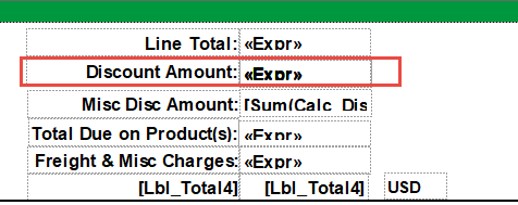

AR Invoice - Sum DocDiscount
I am having trouble summing the DocDiscount field at the bottom of the invoice reliably. It seems when an invoice is a single line with a miscellaneous charge (or two) the discount is doubled. So I actually set up two fields with visibility rules to handle a dataset with one line vs a dataset with multiples and that was working ok.
This is now happening with a dataset that contains multiple invoice lines and the discount on the last line is doubled and I’m not sure the best way to proceed. Feels like I’m just spinning my wheels.
=Sum(Fields!DocDiscount.Value) * - 1
invoice discounts
Looking further I suspect it may be a join, I found a visibility rule hiding the duped line. But if it was a bad join I would think more than just the final line would be duplicating.

I just copied the standard SSRS and the same behavior is present.
I thought I had it good with this formula but the logic dies when mass printing invoices.
=IIf(
    Max(Fields!Calc_InvoiceDisplayLine.Value, "ARForm") <> CountRows("ARForm"),
    (Sum(Fields!DocDiscount.Value, "ARForm") - Lookup(Max(Fields!Calc_InvoiceDisplayLine.Value, "ARForm"), Fields!Calc_InvoiceDisplayLine.Value, Fields!DocDiscount.Value, "ARForm")) * -1,
    Sum(Fields!DocDiscount.Value, "ARForm") * -1

It is a scope issue but I get an error on the lookup function when specifying a different scope.
Lines are duplicated if there are multiple miscellaneous charges attached because those are held in a different table, so naturally the row would duplicate the same as in a BAQ. To tackle this I am having our AR person add the freight misc charge to the first line of the invoice instead of the last line because I was not having any luck returning the MAX line number.
So to make sure the DocDiscount field sums accurately after adding the freight misc charge I added a subquery to the SQL statement to return the DocDiscount value of the first line of the invoice.
 (SELECT T2_Sub.DocDiscount
     FROM InvcDtl_" + Parameters!TableGuid.Value + " T2_Sub
     WHERE T2_Sub.Company = T2.Company
       AND T2_Sub.InvoiceNum = T2.InvoiceNum
       AND T2_Sub.InvoiceLine = T2.InvoiceLine
       AND T2_Sub.DocDiscount IS NOT NULL) AS SubDocDiscount
The I subtract SubDocDiscount from the total of DocDiscount.
=(Sum(Fields!DocDiscount.Value) - Fields!SubDocDiscount.Value) * -1
This seems to be working and hopefully it stays that way.
