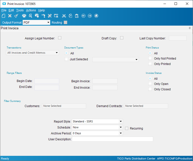

Is that possible? Can I build an RDD from scratch and make it work in the Print Invoice screen (pic below)?
Basically, I don’t get how the screen inputs would get passed into a different RDD. (It’s really only the invoice number that I care about.)
