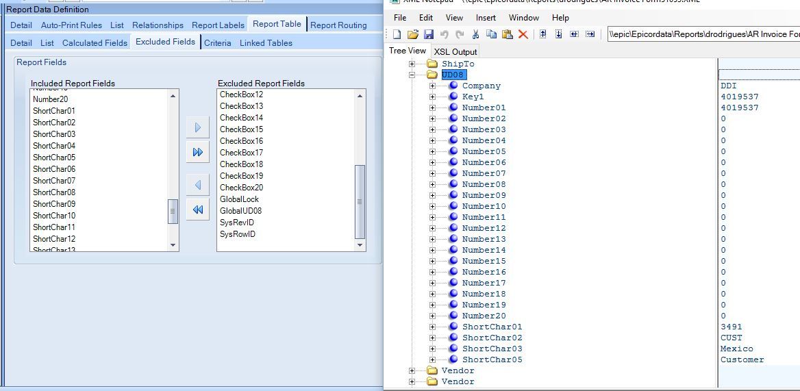

We have a duplicate ARForm that has a few additional linked tables including UD08. Most of the data shows up fine when AR invoice is printed but one specific field (ShortChar04) the crystal reports file uses is not being included in xml dataset. See screenshot below.
Anyone ever run into this issue ?
ps: I queried the database and the record for relevant ShortChar04 and it has a value for sure.
Is there any field security set on that field? Normally when there is no value (null) for that field, it will not show up at all in XML or CR. This can be caused by a user not having read access to this field.
Did you copy the report from ARForm? If you added tables did you create a new Report Style for the ARForm?

Thanks for the reply. Field security is set to full access. Other fields are being populated fine in the form/xml dataset.
Any other ideas ?
Thank you.
Hi @Jonathan_Lang
Thanks for the reply. Yes duplicated from ARForm and created new Report Style for ARform with new Data Definition.
