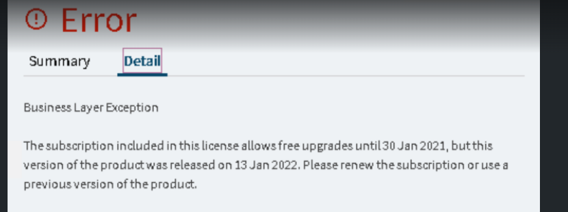

Currenlty, I’m using Aspose PDF to download pdf files, and I just copied the raw XML into my code from the “Ice.Lib.Resources.Aspose.Pdf.lic” file directly in Kinetic 2021 version in custom function, but when I used Kinetic 2022 version, it didn’t work and caused an error because I used the 2021 license key in the 2022 version, and when I used the “Ice.Lib.Resources.Aspose.Pdf.lic” file for Kinetic 2024 version, it worked in 2022 but failed in 2021.
