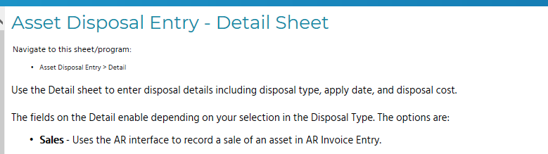

Hi
I’m looking at sales of a fixed asset, I’m in Disposal Entry and choose Sales as Disposal Type, however, I don’t see how it connect to AR Invoice Entry, any idea? How do I create an AR invoice, there is no asset line option.
@JTBAQ
I believe that refer to a SO linked to a Misc. AR invoice.
  • Create a SO
  • Create a Misc. AR Invoice
  • Shipment to be done through the Misc Shipment.
OR
If the asset is sold, then the better approach would be
  • Dispose it through “Transfer”
  • Book the sales order
  • Customer shipment entry
  • Invoice.
