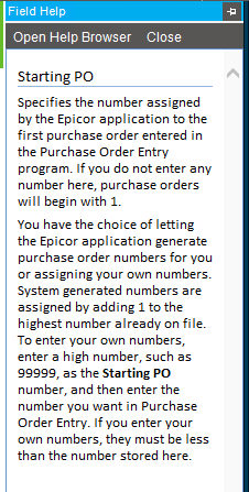

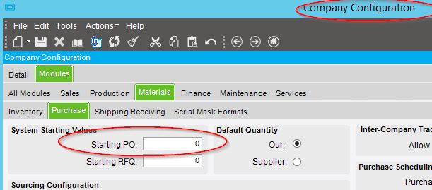

What is your “Starting PO number assigned in the company setup?”, my guess is that it is 200000. Set that value higher, and you will be able to manually enter numbers up to that value.
Thank you so much, Time. What is the path to set up this value?
Thank you, Tim. I got it.
