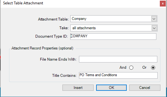

Setup APR to Email PO’s and I’m trying to attach the PO Terms as a 2nd document.

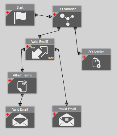

Here’s my layout:
The Action is created with the PO Terms under Company and I setup a Document Type for Company

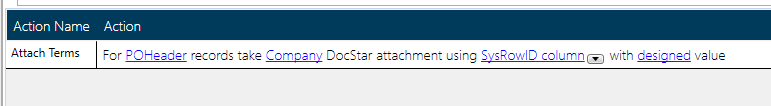

Email sends with the PO but the PO Terms will not attach.
Currently working in 10.1.600.35.
Fixed it. Using the SysRowID doesn’t work, you need to select Key Fields and no selection is required.
