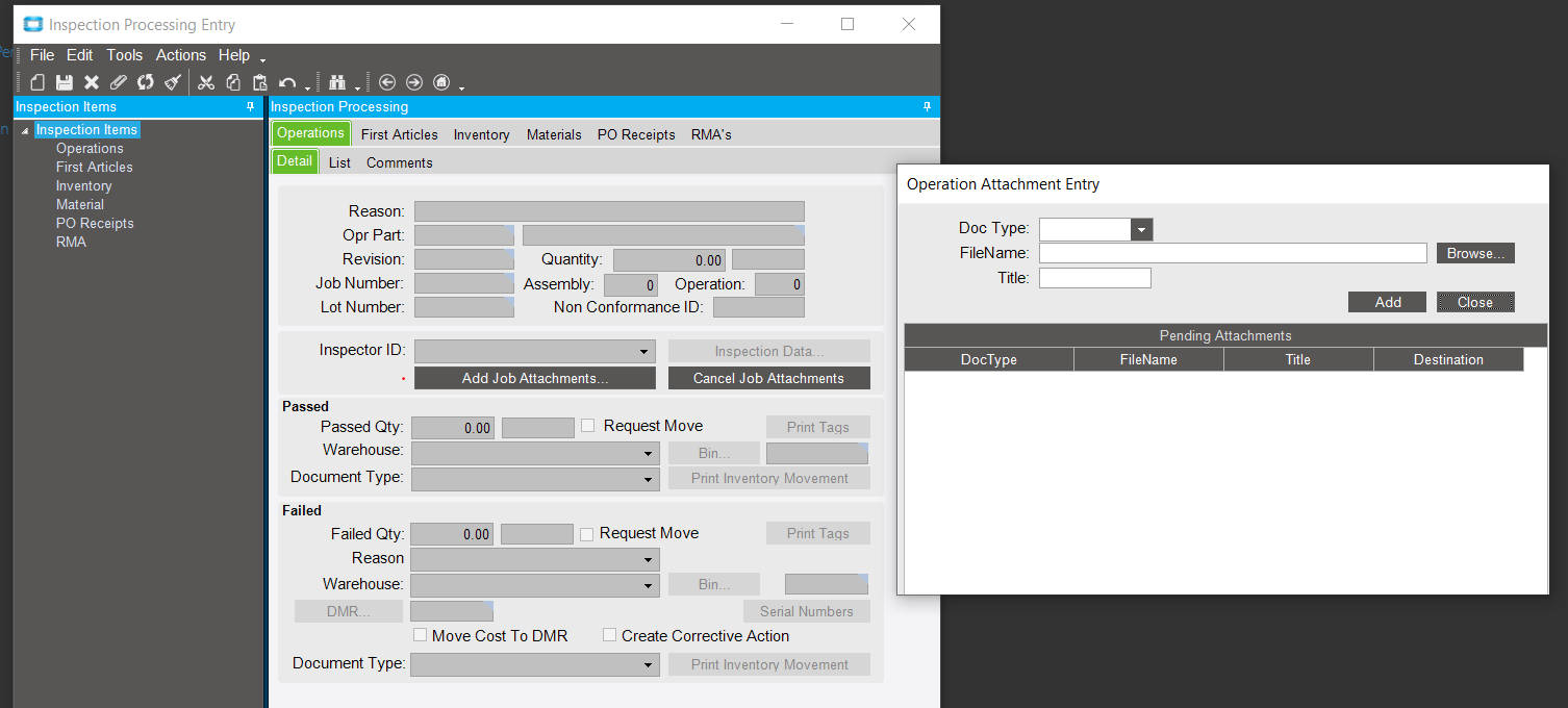

You could achieve it by doing UI customisation on the form to leverage a form to upload documents then utilise the adapter method to attach where you require for example we do something similar for Job inspection & Non Conformance.
