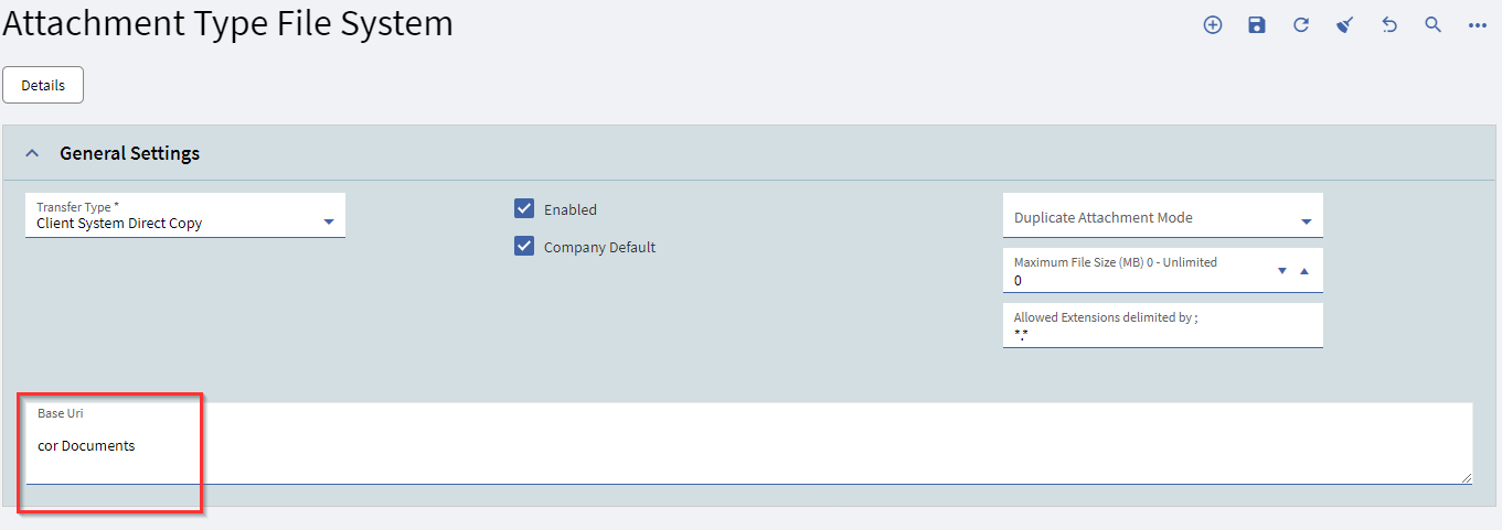

Has anyone else noticed an issue with base URIs on 2024.2 I can correlate the issue to starting after our upgrade from 2023.2 to 2024.2.

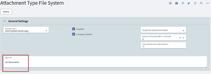

What we are seeing is a truncated Base URI in both companies, but the it’s only giving us the end of it not the start of it. It is also correct in the database, but it is not correct in new attachments or the attachment type screen.

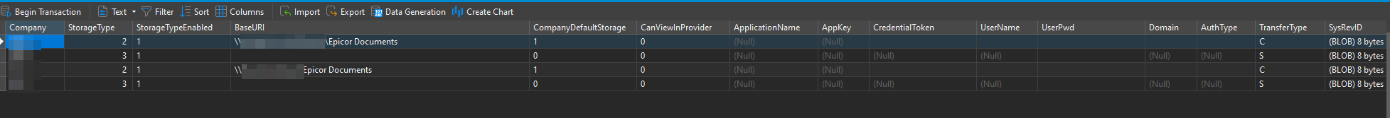

This is what the values show in the database the two are for each company record.

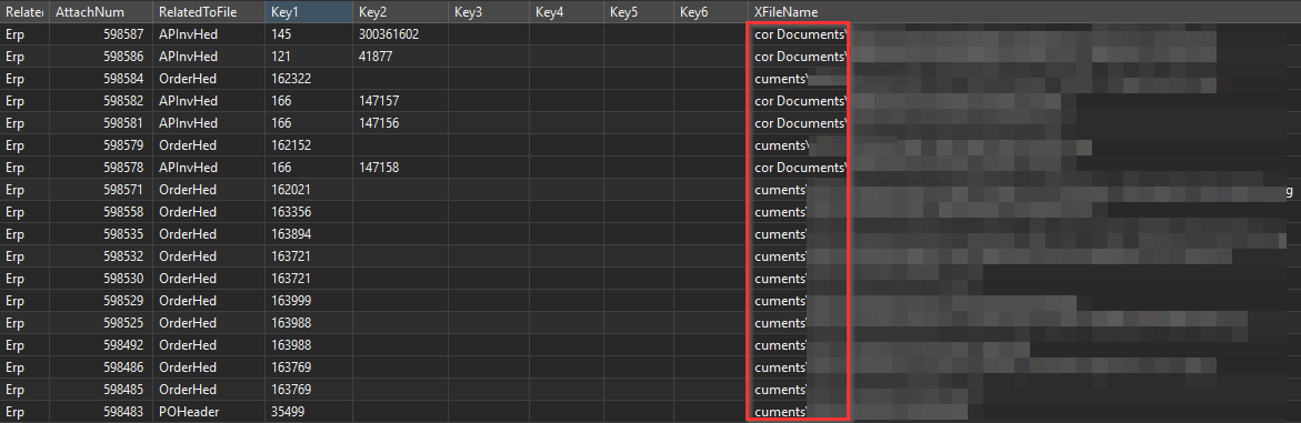

Note that in the actual attachment tables it’s cut short to starting with “cor Documents” in one company and “cuments” in the other.
This is reflected in the actual screens even though it’s not stored in the database that way either!
I can even try to change it to anything else and it goes sideways.

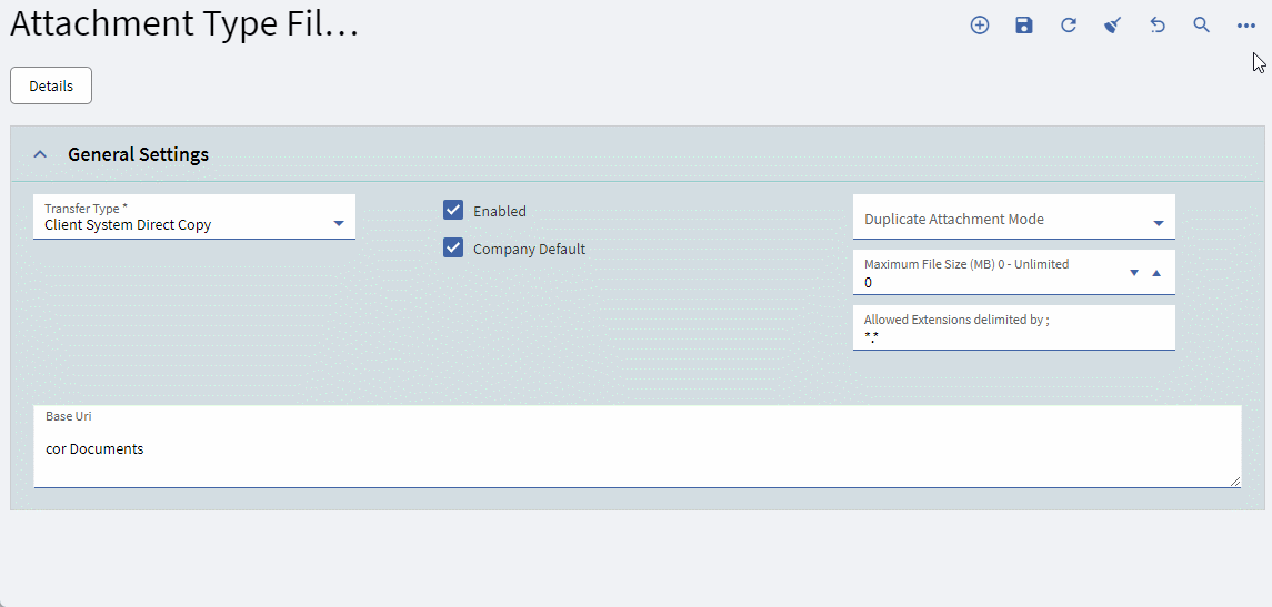

GIF
Notice it’s stored as I pasted in the DB, but it won’t be correct on new attachments.

Don’t know don’t use any of them. It seems to work if I don’t give it a UNC path The documents haven’t uploaded either, likely because it’s not a valid path. No errors in the Event Viewer for this issue. I just saw one come through so I can confirm that in the event viewer.
Looks like it’s UNC path breaking it. If I give it a shared drive letter path it’s fine with that. But where it is breaking seems so random. It must be something with the slashes?

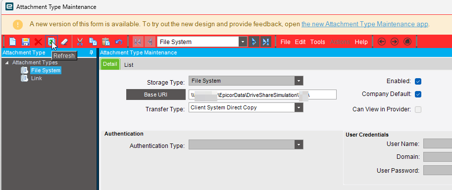

Can confirm it’s working great in my 2023.2 development system, but is also broken in our 2024.2 testing system.
This is the path working fine from our 2023.2 dev system. Works the same in browser version as well.

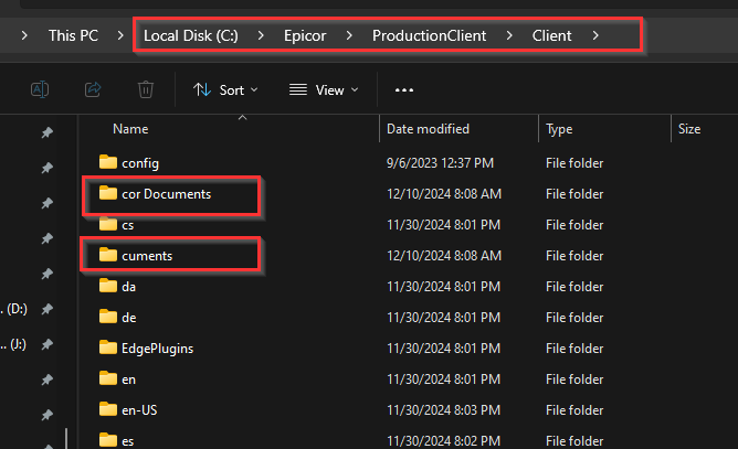

We found the attachments that went to “nowhere” they were on the client computers in the client folders because it was using a relative path.
Ran this script in PDQDeploy against all client PCs to generate a report on which clients had the files and then copy pasted them back to our base URI.
if ((Test-Path "C:\Epicor\ProductionClient\Client\cuments") -or
    (Test-Path "C:\Epicor\ProductionClient\Client\cor Documents")) {
    exit 1
} else {
    exit 0
Then ran this SQL to fix the attachment paths
UPDATE Ice.XFileRef SET XFileName = CONCAT('\\server.domain.local\company1\Epicor Do', XFileName) WHERE XFileName LIKE 'cuments\%'
UPDATE Ice.XFileRef SET XFileName = CONCAT('\\server2.domain2.local\company2\Epi', XFileName) WHERE XFileName LIKE 'cor Documents\%'
Generated a list of all the attachments attached since we upgraded 11/27
SELECT XFileName FROM Ice.XFileRef WHERE XFileRefNum >= 194910 AND DocTypeID = '' ORDER BY XFileRefNum DESC
