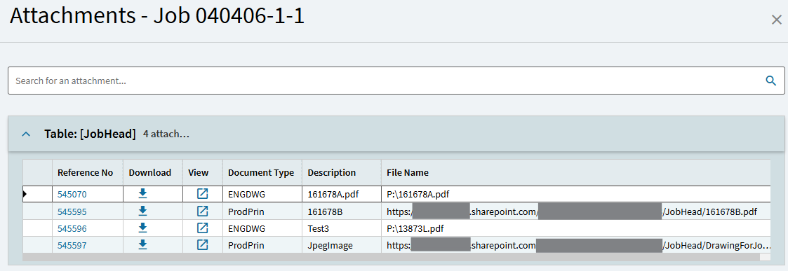

  • Link SharePoint to Epicor, test connection is successful
  • Place engineering drawings in SharePoint and has URL
  • Attach the drawing to the Job, can both view and download drawing from Epicor

I wrote a query to retrieve the list of attachments on the job. The query will return the XFileRef_XFileRefNum and XFileRef_XFileName. The XFileName holds the path to the engineering drawing image files on Sharepoint. The path is a URL.
In your BPM, step 2 is to get the image data and in your statement you are looking inside the database. I must GET my data from SharePoint using a URL address and it is not inside the database.
Is it still possible to retrieve the images when they are in SharePoint and not inside the database?

Yes. We have established a connection with SharePoint. The test connection says successful. But the image files are not in the table Image in Epicor.
If that is the case, then are you saying that I can use the
//Get the image data for those and put the image data in a Dictionary<string, string> var images = Db.FileStore.Where(x => imageList.Contains(x.FileName)).ToDictionary(key => key.FileName, val => Convert.ToBase64String(val.Content));
Are you saying that the SharePoint file can be found in Db.FileStore?
I think he’s saying attach the image to JobHead, then the file will be in SharePoint JobHead folder
Yes. I have the images attached to the Job and they are sitting in the JobHead folder.

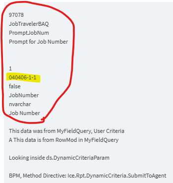

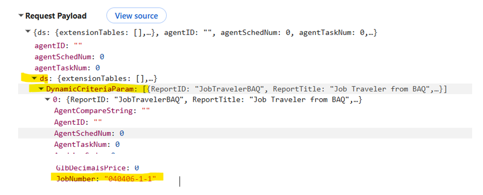

In the BPM, I need to know the parameter that the user enters. Here is the trace after the user enters the Job Number.

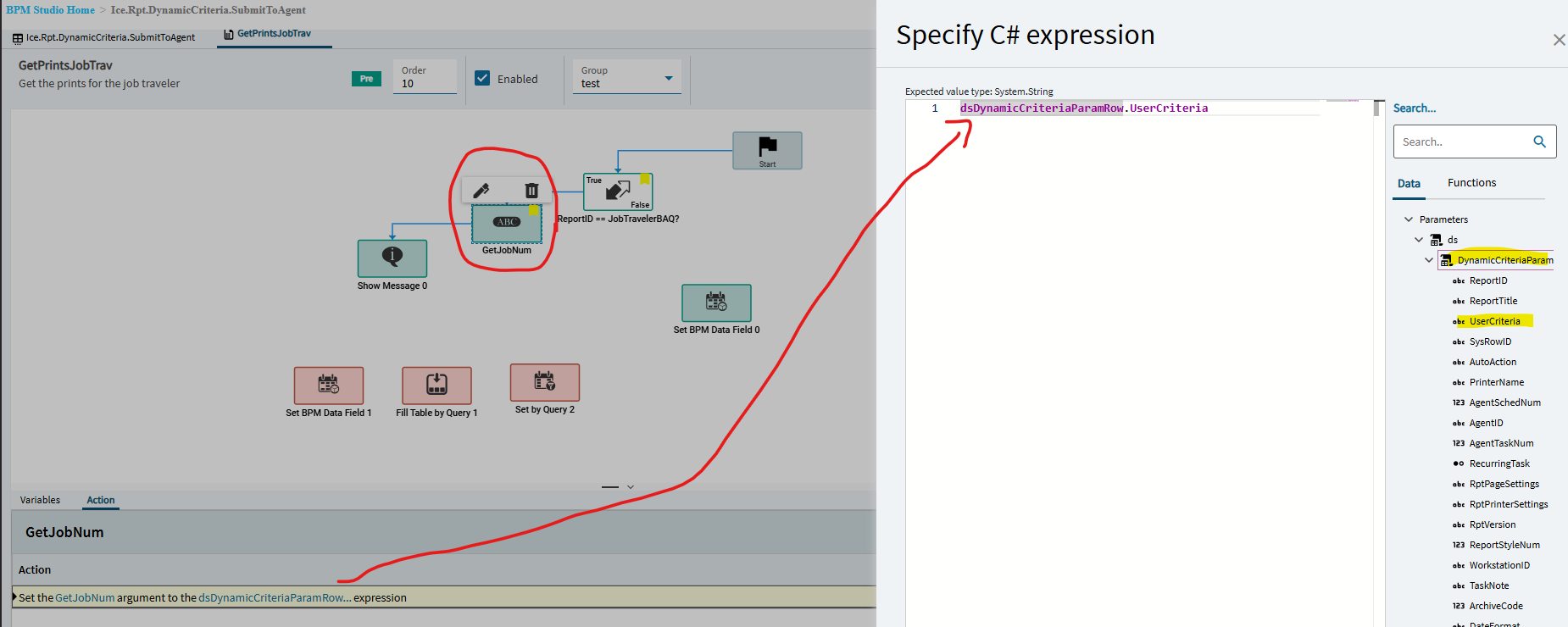

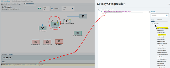

In the BPM I am trying to grab this parameter.
Using a message to print out my variable, this is the data that I am gathering.
My variable holds all the data circled in red. I just want the job number, highlighted in yellow.
I have also tried dsDynamicCriteriaParamRow.UserCriteria.Select(JobNumber). But I get an error that name ‘JobNumber’ does not exist in the current context.
One more piece of information, in application studio the field is bound to ReportParam.JobNumber
Question) How do I only grab the job number?
If I remember, UserCriteria is an array, so you would address by index
UserCriteria[6] or whatever is the correct item
