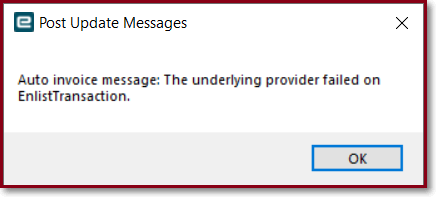

I have a situation, where I need to add a Misc (row in InvMisc) charge to an AR Invoice. Method directive works fine if an invoice is created through UI!
But, we have several customers who are auto-invoice enabled. I have tried adding Data-Directive to InvcHead (once posted = true) and tried calling STANDARD directive to create Misc record, but this failed as the invoice already posted. I am running out of options. Is it safe to INSERT row into InvcMisc directly inside In-Trasaction data directive? If so, how can I do this?
Thanks, SK.
I tried the below code in InvcHead.In-Transaction and got the below error (screenshot).

Error:
InvcHead_Error
Exception:
Query failed to run
System.Data.Entity.Core.EntityException: The underlying provider failed on EnlistTransaction.
—> System.Transactions.TransactionException: The operation is not valid for the state of the transaction.

Perhaps you could try adding the misc charge to the shipment instead…
Thank you, @Hally. I did add the Misc charges to the shipment and it works well. Only observation I have is that, in the Shipment, I can only add Misc charges to the Shipment Header. But, when the Invoice is created, it applies to the line level and to the line 1. This to me is inconsistent as I wanted to add the Misc charges to the Line level.
It works for now.
Thanks for your response and suggestion.
-SK
It will do that even if you add a misc charge to the header of the order.
This is what we did as well for new tariffs. We ended up summarizing the shipped tariff amounts and adding to the shipment
