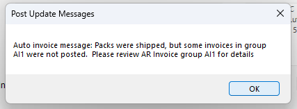

The other option may be a bit unorthodox. You could ensure your Auto Invoice/ERS Orders is configured in Company Maintenance/Sales then create all your orders lines as Time and Materials. When you ship the pack through customer shipment entry. With the lines set to time and materials, the Invoices will get generated, but be put on hold and not posted.
Out of the box you will get this message.
It should be possible to have two BPMs. One that set the Time and Materials flag on the order line, and another one to override the Post Update Messages when you ship/invoice.
The final step to post the invoices would be to go into each group and validate each invoice, take them off hold, run the Edit List, Print/email, then post. It would be possible to use a dashboard to do that if you wanted to streamline it a bit.
