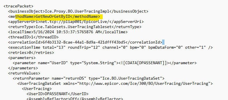

This is what I get when I run the trace:
I tried GetByID on sales order, but it doesn’t look like that worked when I converted a quote.
I ran the trace and it was GetByID, I just needed to set it to field of all rows to get it to populate as true when converted.
You highlighted the GetNewOrGetByID method of the UserTracing object.
