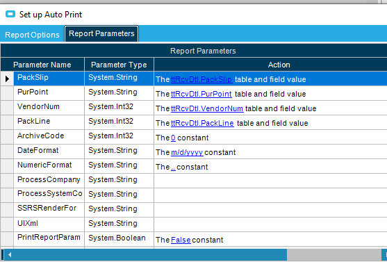

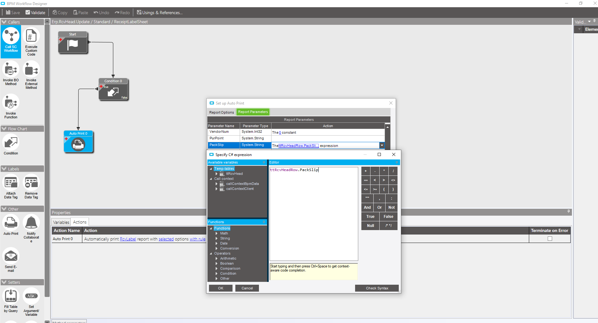

I am trying to auto print SSRS receipt label when a PO is received using receipt entry menu. I have created a data directive bpm. I am getting an error " valid pack slip is required". May be i am missing a step? Help would be much appreciated.
Ours looks like this:
We needed all those values filled in for it to work. Maybe that could help you.

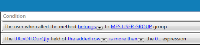

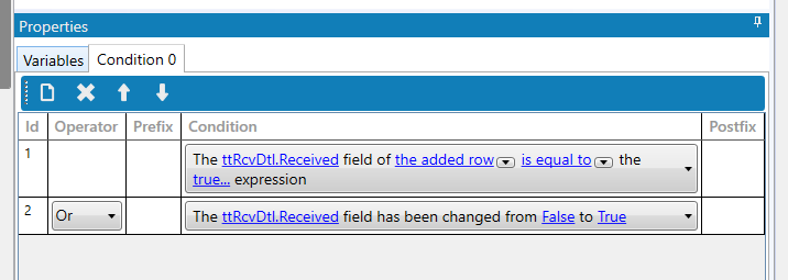

We have a condition statement that checks for added rows only, to make sure we only get one label.
Not sure if its the most elegant way to do this, but it works for us.
I had to do this too,but not sure if it was the SAME exact condition, but yes we were getting labels for all past receipts.

below are the conditions on the BPM.
Any thoughts?

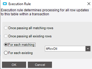

What method are you hooking on ?
Standard Directive on RcvDtl table ?
Yes. Standard on RcvDtl

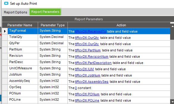

Maybe add an additional filter where Receipt Date = Today().
Alternatively…
Maybe hook on to the PartTran table instead with a standard directive.
where TranClass = R and is a added row.
All the other report parameters seem pretty accessible from there.
