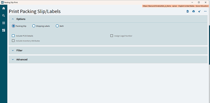

The out of the box version of the report style for bartender labels is the GenShip report style, and typically that would be generated from either setting the autoprintready flag on the erp.ShipHead table on a standard data directive (Which I think you got anyway). I don’t think the AutoprintReady field is displayed on the Customer Shipment Entry Screen by default.
My understanding is that this also can be fired from using the standard packing list report and selecting labels or bot from the options.
