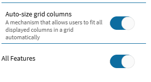

I did see in the “Preview Features” there was a new option for Auto-size grid columns. I tried turning it off an on but didn’t see a difference so I put it on the list of things to look into.
It doesn’t appear to hide/add the option you mentioned in the overflow menu but I wonder if its still related in a way.
We have the option available even with it turned off in preview :woman_shrugging:
Same, I wonder what it actually does then. I didn’t see anything in EpicWeb or EpicCare for this specific preview feature. Do you know where they announce the details for them?

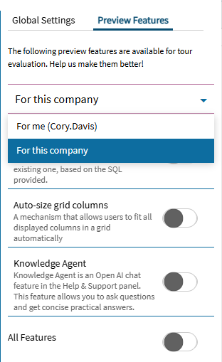

Just confirmed with two other users, they do not see the “Auto resize columns” option in the overflow menu but I do. Must be permission related somewhere. Also, they do not have the preview features section.
We reached out to Epicor regarding this and learned that Security Managers can enable the features by selecting “For this company” in the “Preview Features” section. Once this is enabled for the company all non-security users should be able view the “Preview Features” section and enable the feature themselves.
In the area where you can turn on preview features, do you have the ability to change the dropdown from “For me” to “For this company”?
Oh cool, I do see the option to turn on preview features for the company. Thanks!

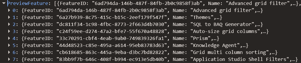

If it doesn’t enable it, you could run a script to iterate a rest call against each user name and enable the feature. It looks like 1 call can be made to enable it tenant wide for all companies, and also scope to Security Group, i’ve not tried either option. Call “DisableFeature” to do the inverse.
Each feature has a GUID:
a REST call to Ice.LIB.FeatureFlagsSvc/EnableFeature with params:
“featureID” set to the appropriate GUID above.
“level” = 1 (TenantID) 2 = (Company) 3 = (SecGroupCode) 4 = (UserID)
“target” = The appropriate object matching the level (TenantID, Company, SecGroupCode, or UserID)
