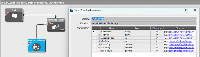

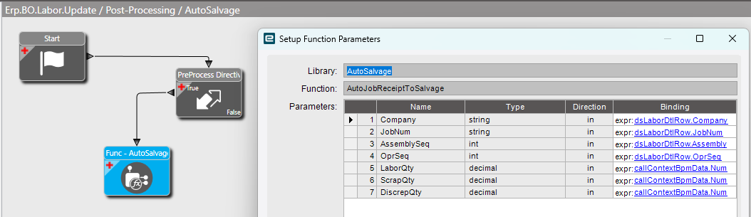

From a high level, BPM triggers on Labor.Update
  • Pre-Process gathers initial values and stores in BPM context fields
  • Post-Process pulls in context values and triggers the Function.
  • Function calculates the salvage amount and cost
  • Then runs the PreUpdate and ReceiptSalvage methods.

Function Code:
// Parameters: Company, JobNum, AssemblySeq, OprSeq, LaborQty, ScrapQty, DiscrepQty
