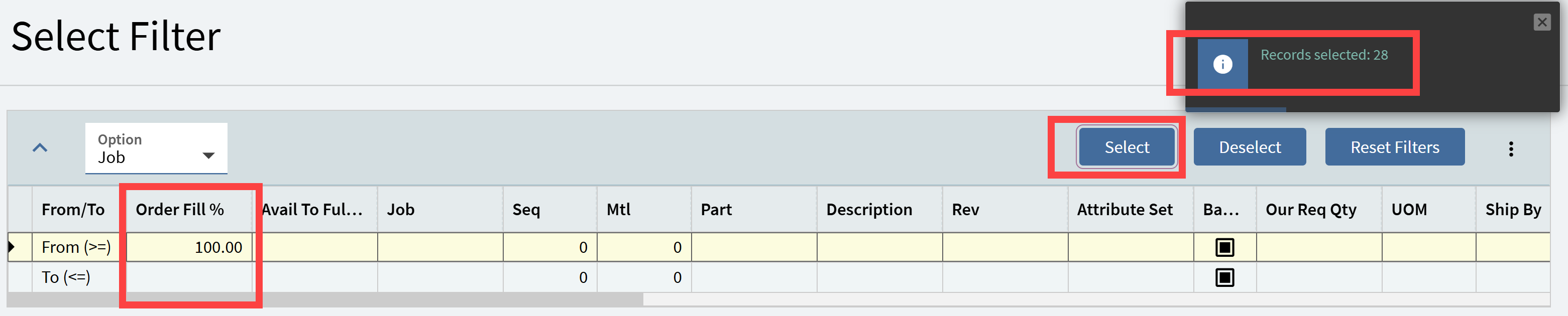

If I understand your question - you only want allocate to jobs that 100% of all material available.
Using Fulfillment workbench -
Two ways -
  1. Search for all jobs within the time frame that you want to allocate and set the filter at the top to 100% and click on select all.
    No filter
Set filter to 100%
  1. Use the select filter to select the jobs that have 100% available.
Set your select filter to 100%
Selected records.
