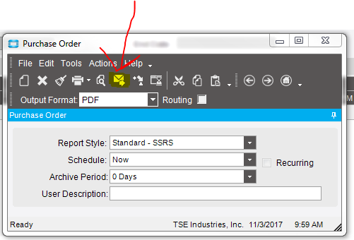

When printing an SSRS report, in this example PO Form, there is an option to send it via email.
Is there a way to get the email address to auto-populate, pulling from the Supplier, purchase point?

So, is there no way to do this with BPM?
All things are possible with enough custom code in a BPM ™, but, there isn’t a standard way to accomplish this using a BPM.
