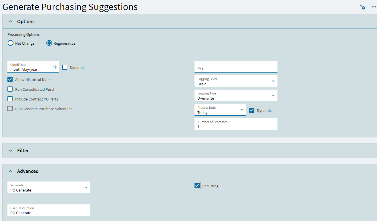

I set up the Automatic Generate Suggestions as shown in the screenshot below.
But the periodic “Regenerative” doesn’t work. Is there anything else I need to configure besides the settings I made?

I don’t see a problem with your settings. We use a similar configuration:
Is it not running at all, or it is running but not getting the results you expect?
Are there any filters being applied accidentally that might limit the results? The filter section is collapsed in your screenshot.

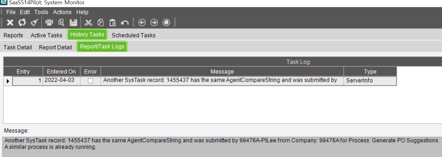

You could check the Epicor System Monitor for any errors occurring while trying to run the Task, or enter a filename in the Generate Purchasing Suggestions ‘Log’ field and check the log file after running.
