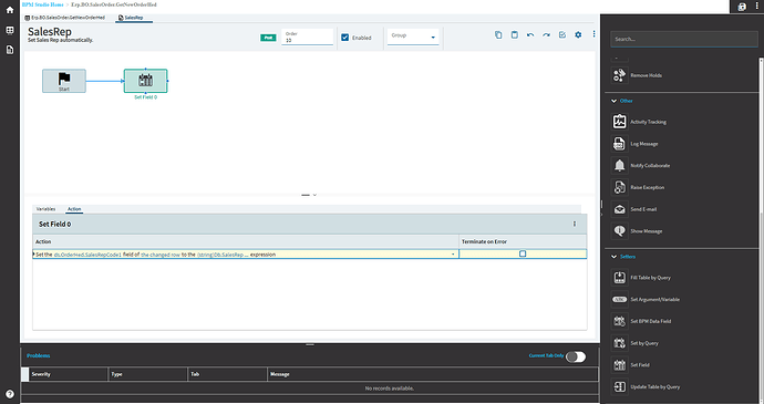

I’d create a post-processing bpm on SalesOrder.GetNewOrderHed and then use a set field widget to set that specific field (OrderHed.SalesRepCode1) to the work force account associated with the current user.

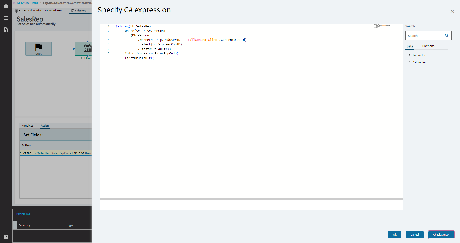

Yea you’re expression will need to be something like this. I didn’t actually test this I just took a similar expression of mine and rewrote tables and fields.
(string)Db.SalesRep
    .Where(sr => sr.PerConID ==
        (Db.PerCon
            .Where(p => p.DcdUserID == callContextClient.CurrentUserId)
            .Select(p => p.PerConID)
            .FirstOrDefault()))
    .Select(sr => sr.SalesRepCode)
    .FirstOrDefault()
thanks, i tried the code it didn’t work. I will try again.

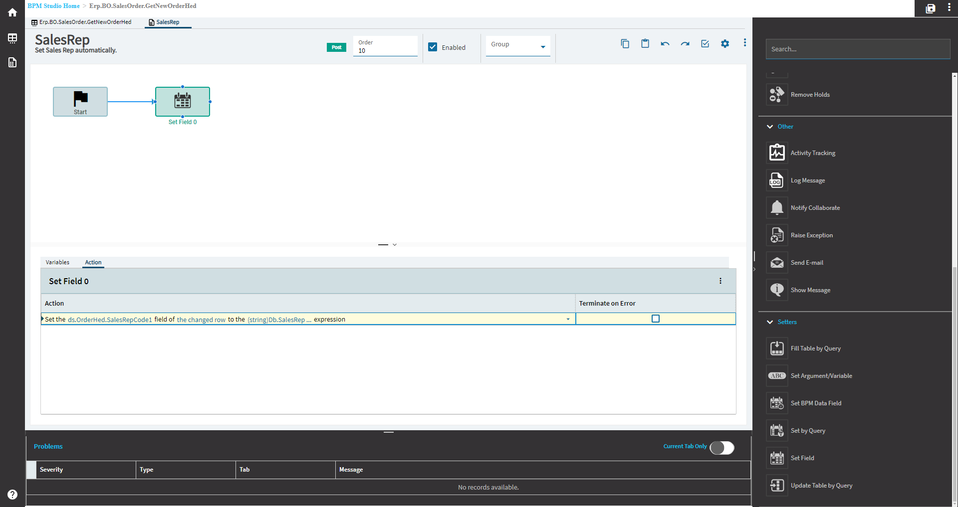

I went ahead and set the whole thing up in my test site and it worked. Show me your whole bpm.
That looks the same as mine. What about yours didn’t work? Do you have a work force account that’s linked to your User ID through person/contact?

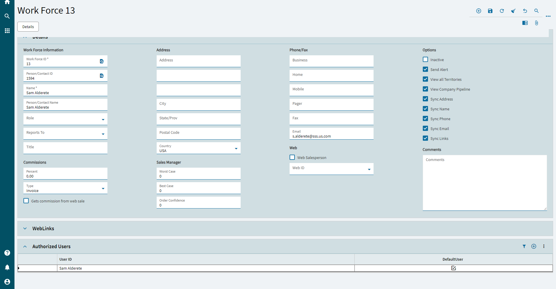

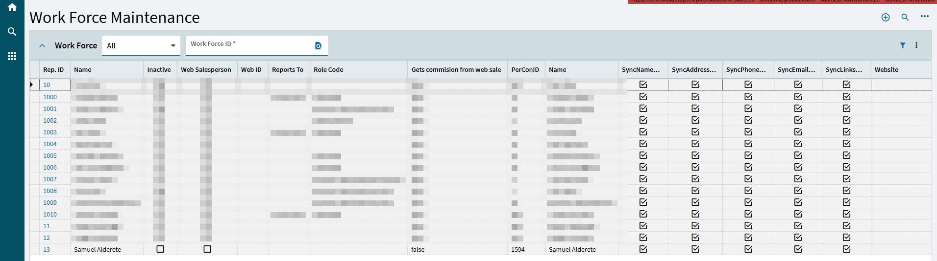

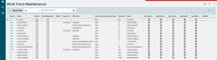

I did add myself on the workforce
Is it automatically link to person and contact if I created a workforce?

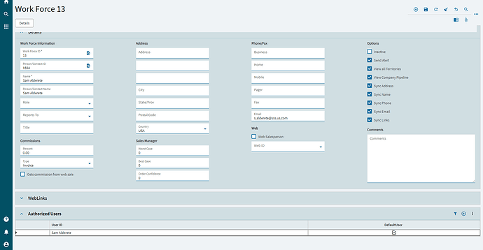

Did you set your workforce account to “View all Territories”
And Add yourself as an Authorized user
Thank you Chris I will try it immediately
I did check and set it, but still not working

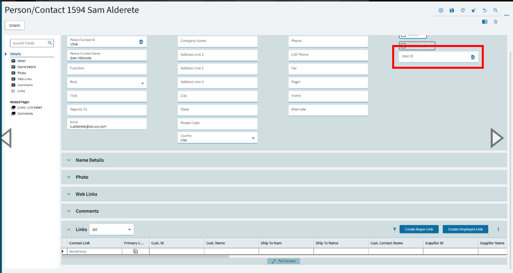

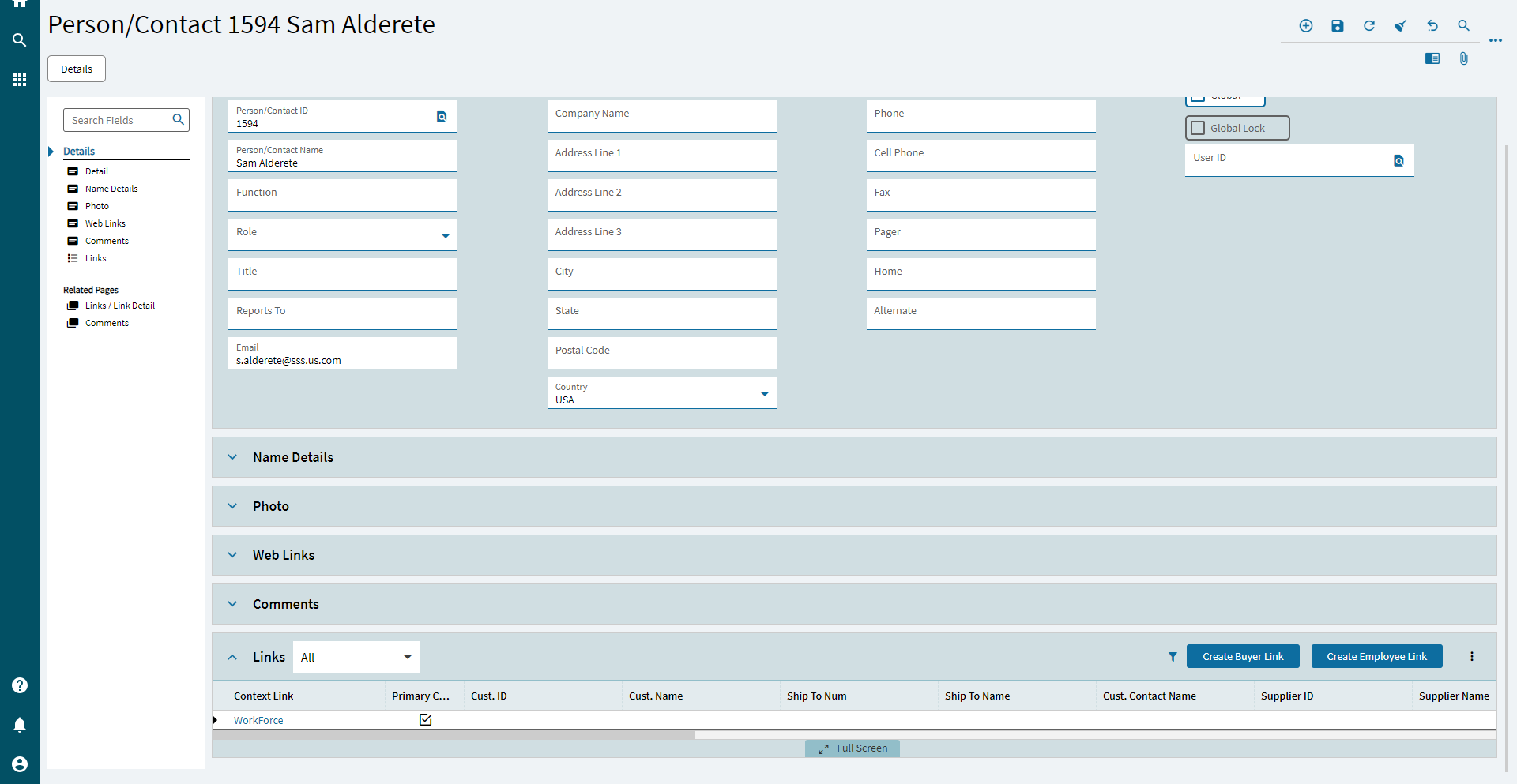

This does not link automatically. You’ll need to verify that your work force account is linked to your person/contact ID and than your person/contact record is linked to your userID.
It seems its link
This needs to have your user ID
