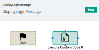

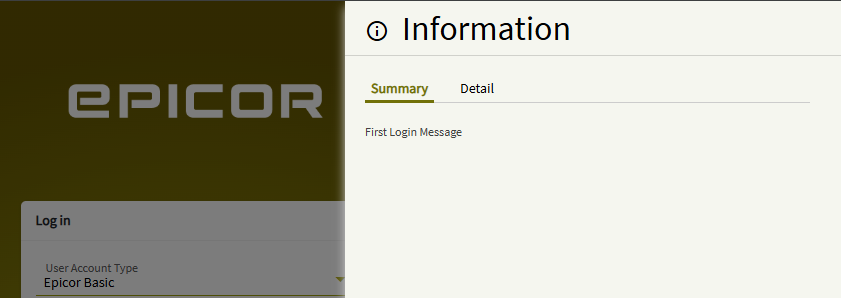

I tested this in 2025.2.10, and it seems to meet your requirements. I moved it away from SessionMod.Login to another BO that fires only once on login in the hopes that it’s a little less dangerous :slight_smile:
If you wanted to block login without agreeing, you might be able to move this to SessionMod.Login and change it to a Yes/No prompt, and throw an exception on No. that should prevent login.
InfoMessage.Publish("First Login Message");

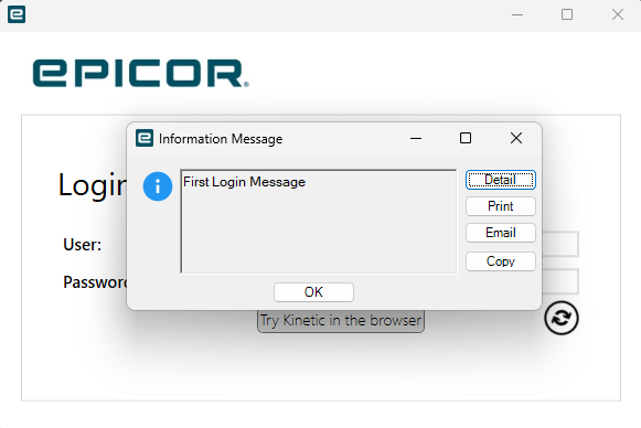

Works in Classic, too.
Yes! For what you need, with just a notification to the user, it is doable just like @GabeFranco showed.
