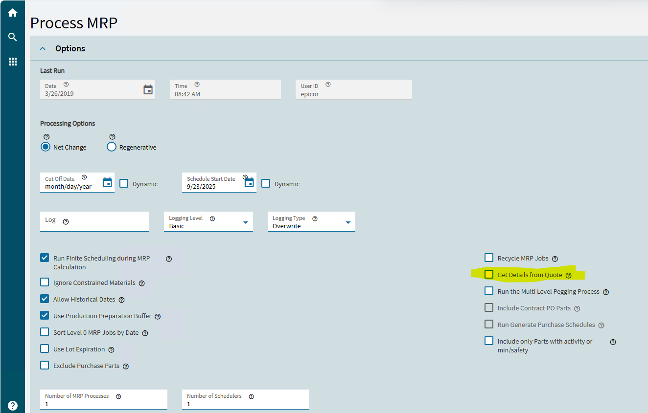

I went to the Ranger Design site, and it looks like you have a highly configured product. Do you use the Product Configurator or CPQ/KBMax? Do you engineer on Quotes?
no we don’t use any of that yet, that is a topic for another day :upside_down_face:. like i said, everything on a SO has an approved revision set up. it is it something custom that we are selling it gets set up by engineering before the order is entered.

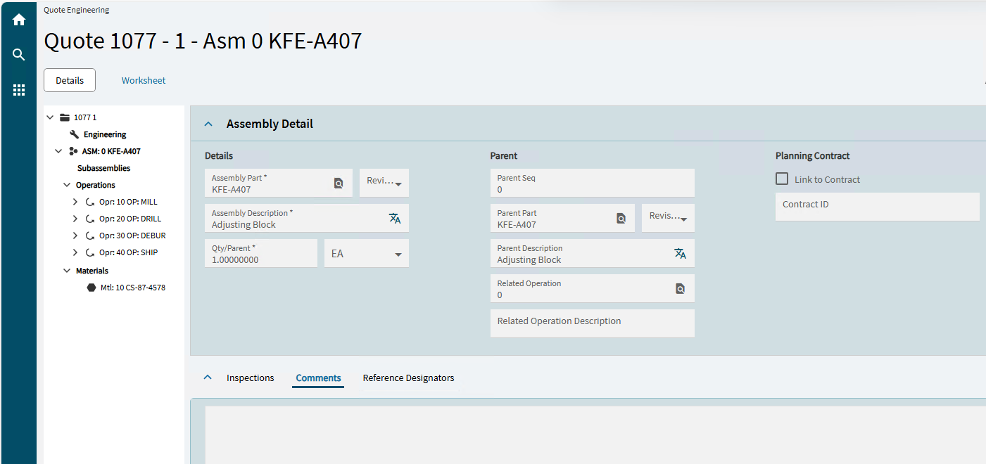

The only reason I brought up engineering in the quote is then I can see a path to a pick list. You have all the same engineering capabilities in a quote that you do in Engineering Work Bench.
If you still want to create a method for a part, you can easily do a Get Details from the Quote Line into the Part Revision.

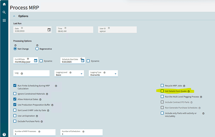

In MRP, you can do a Get Details in quotes that are linked to orders. This will drive the demand for MRP.
If you peg the demand when running MRP, you may be able to create a Pick List for the suggested jobs linked to the quote. Again, just a different way to look at it.
