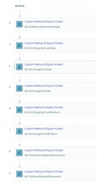

I have done all the attached Custom Methods.
HELP MY SANITY!
my custom items I used.
