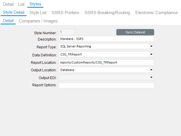

I then considered the situation where what happens if I only wanted the the calling report and not the subsequent ones, Let’s use the report style and check out the systask Params.
and surprise, surprise, the SysTaskParms.ReportStyleNum is not populated!
Has anyone seen this before? Have I stumbled across an issue?
An issue between the keyboard and the back of the char…The ReportStyleNum is found in the ParamInteger field not the ParamCharacter…Duh!
