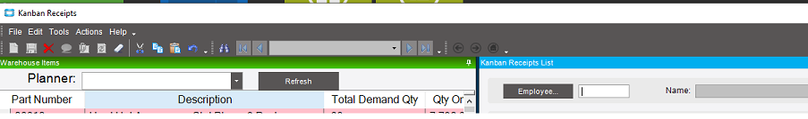

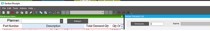

The screen is Kanban Receipts. The left panel is Warehouse Items. Sorry I was confusing.
can you capture and paste a screenshot?
The primary question is, can I autoselect a combobox which is what Planner is in this scenario. If so, what do I need to do. I tried finding an EpiDataView but not able to find it.

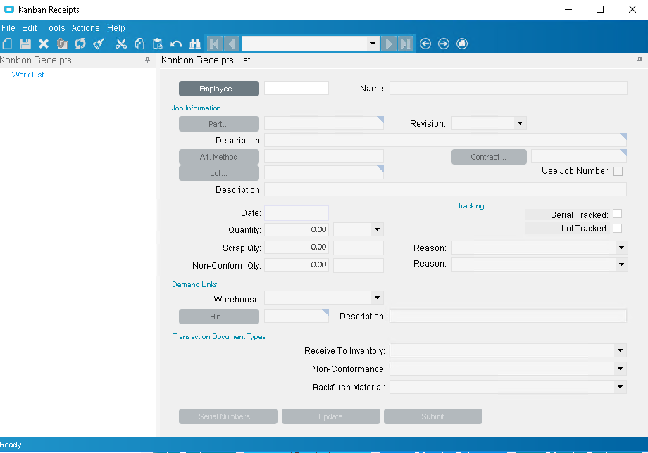

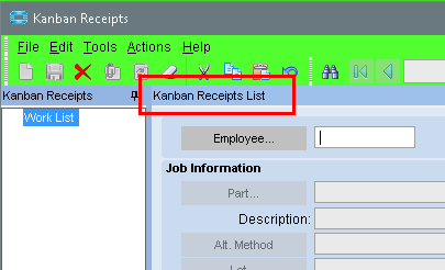

Is that a customized version of Kanban Receipts? Mine (E10.2.300) only shows the lone pane “Kanban Receipts”, and no pane for “Warehouse Items”
I found out it is a customization already. I am relatively new to Epicor so I didn’t realize that. They are running a BAQ and I modified it to get my desired behavior.
I was wondering… that didn’t look familiar, which is why I asked for the screenshot.
I think this customization has to get an action “Refresh” to load data Planner. If you want to autoselecting the planner, you have to define the rule.
