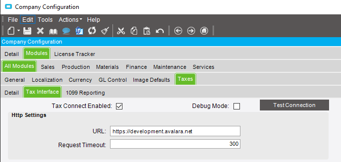

Kristine, I am assuming you are testing this from your Epicor Test environment, correct?
If so, make sure that the company configuration settings are set up to connect to the sandbox avalara environment. Just below that is where you put in the test user and what not.
@utaylor Yes I am. Using the development URL with the test credentials I received from Avalara support.

What happens when you click, “test connection” in company maintenance?
@kfierce we are getting this too. Have you found a solution?
@utaylor we received a username, password, account ID and a License Key from Avalara. Did you use the Account ID and License Key for Account User Name and Key/Password?
Yes, that is what we used.
the URL is https://development.avalara.net
This is exactly how we have ours set up. We have an open case with Avalara for getting the User Name and Password so I’ll reply to them on that ticket.

@utaylor - if I read the email correctly if you don’t have an active sandbox you could request access to Avalara’s universal sandbox to complete the connection test. It specifically says no transaction testing just connectivity. Right now I can’t even get connected without getting an error.
@utaylor @kfierce This is my underdstanding also. We don’t have a separate sandbox because it’s so costly. But Avalara has set up a sandbox just for testing to ensure you can connect.
Avalara will disable 1.0 and 1.1 but only for their REST V2 API, all versions up to Kinetic 2021.2 are using SOAP, so those will remain unaffected for now.
If the account is for sandbox you should be using https://development.avalara.net as mentioned above.
However if the account is for production you should be using https://avatax.avalara.net
They should be different accounts to avoid doing something in the production environment.
