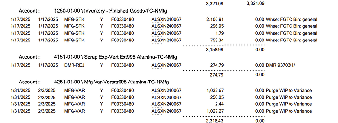

Its coming from the job itself. We have only one mfg-stk per job when all costs have been added. We use scrap and non-conform all parts before deciding what goes to reject and what comes back to the job, Last job we did was for 105 pieces, we send all to Inspection. 9 went to reject to DMR, the other 96 came back into the job before the mfg-stk transaction but the costs to mfg were around $3100 and the variance was around $2,300 so not even close to the cost of 9 that were rejected.
Sorry, I messed up on my wording in an earlier post. Does the Inv/WIP Recon show phantom purge to variance anywhere? If yes, those are the lines that will cause the variance when the job is closed. If there are not any of those entries, do you have a GL account set for variances on the GL control?
Yes there are phantom purge to WIP but doesn’t explain what is causing these variances

That looks like it was run after the WIP was captured as it does not say Phantom. Trying to figure it out after capture is more difficult. You should run the Inv/Wip Recon report before capturing the WIP and see if there are any Phantom entries.

You need to look for transactions that happened AFTER the goods were received to stock. It looks like everything was received to stock on 1/17. Are there any transactions anywhere on the report that happened after 1/17 (other than the variances)?
There were but a very small dollar amount. I did a time stamp on the part tran record for that job and it shows the mfg-stk transaction was done about 10 minutes after the ins-assm was done which returned 96 parts to the job out of the 105 total
