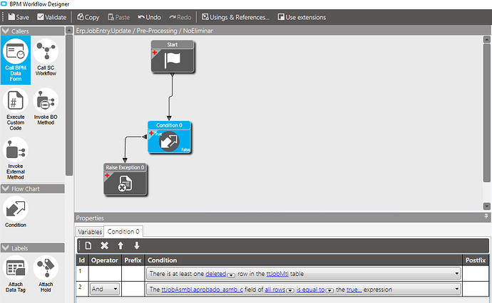

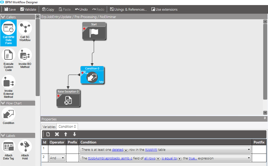

@atorres I would try to do this in a preprocessing bpm rather than a customization. Do a tracing and see what is called before the update so you can stop it before it begins that transaction if possible. Even those are sometimes not stoppable.
Also since customizations are going to go away this would be a better solution going forward.
you would use the same conditions. I have several like this on Jobentry update.
Condition There is at least one deleted row in JobMtl and aprobado_asmb_c equals True.
You should still be able to validate it in the update method… you can check for the RowMod = “D” (deleted)… and if they it is D, and if the checkbox is true, then throw an error.
BPM is the best way to do this.
I don’t think ttJobAsmbl is going to exist in a delete transaction of JobMtl. Use a query to get the value from JobAsmbl like I checked for CheckBox20 from JobHead.
