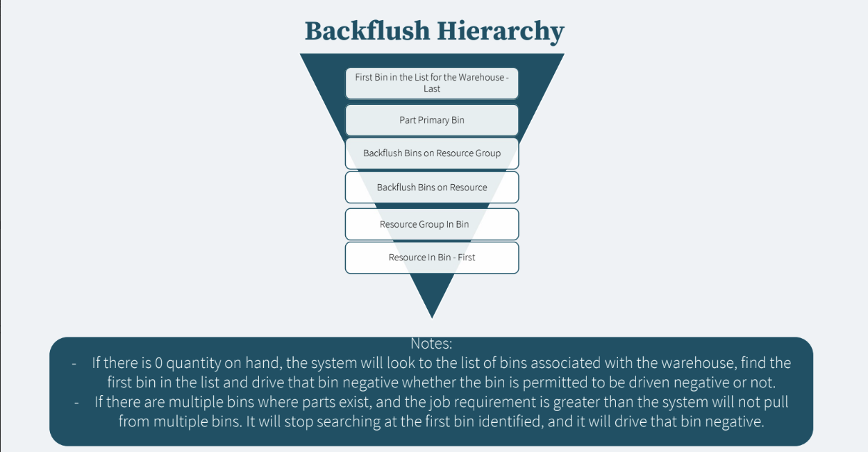

Here’s a picture for the visual learners like me on backflush hierarchy.
This needs to be framed. I may use this from now on.
