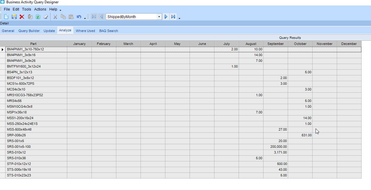

# BAQ | Bucket Totals **Category:** [Epicor ERP 10](https://www.epiusers.help/c/e10/5) **Created:** 2016-10-18 17:04 UTC **Views:** 990 **Replies:** 4 **URL:** https://www.epiusers.help/t/baq-bucket-totals/35842 --- ## Post #1 by @tse.dba I am trying to make multiple bucket qty shipped totals for each month for our parts. Something like this: **Partnum | JanShip | FebShip | MarchShip | ...** **P-part | 4,352 | 773 | 440,923 | ...** Has anyone made something like this? If so, please share as to how. Thanks! --- ## Post #2 by @josecgomez Your profile says you are on version 6? is that right? This was put in Category for E10 so I am not sure... if you are in E10 then you can use a Pivot Query to do what you need. --- ## Post #3 by @tse.dba Current live DB is 6. We are in the process of integrating to 10.1. I will check out the Pivot Query. --- ## Post #4 by @josecgomez Here you go, this should get you there (BAQ Attached) ShippedByMonth.baq (26.8 KB) --- ## Post #5 by @bw2868bond [Thumbs_Up_Sign.jpg] --- **Canonical:** https://www.epiusers.help/t/baq-bucket-totals/35842 **Original content:** https://www.epiusers.help/t/baq-bucket-totals/35842
