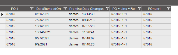

I am attempting to tap into the Ice.ChgLog table to make a dashboard for purchasing to better track when promise dates are changed. I am struggling with trying to break out the delimiter ~ to separate out the PO / Line / Rel.
Example:
Key1 = PO Number
Key 2 = PO~Line~Rel
I would like a calculated field displaying the PO Line and PO Rel, but cannot work out the code to do so. Attached is a screen shot for reference. I am able to break out the PO Num using the following calculated field, but cannot get the line or release. Once I figure this out I should be able to create a join back to the PORel table and include other data points.
LEFT(ChgLog.Key2 , CHARINDEX(’~’, ChgLog.Key2) - 1)
Again, thanks for the help!

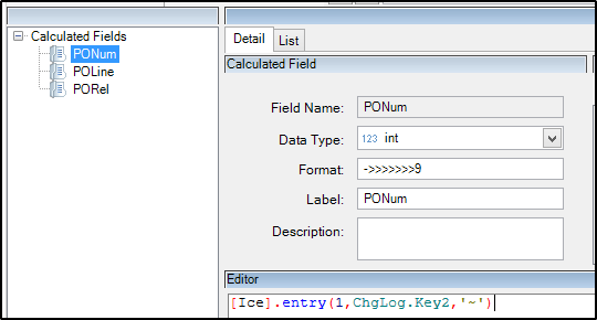

Check out the Range functions.
In your case, add the “~” as the third paramenter.
Add (3) calculated fields

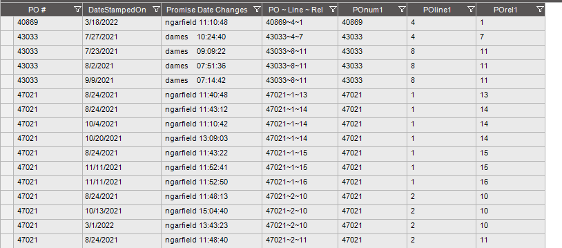

Thank you Mark and Chris. Range is exactly what I was looking for. Had some trouble with formatting on my own, but ended up with a similar solution and now have them broken out across 3 different calculated fields. Really appreciate the help. Below are a couple screen shots for reference:
Final BAQ test:
