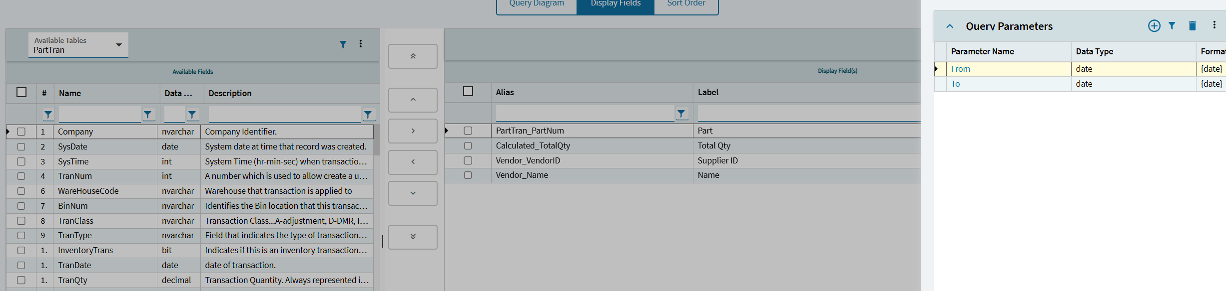

Table PartTran
I am trying to get transactions between a From and To date using parameters. However, the sum always returns the total value for all transactions rather than the date range in the parameters. What am I missing?
I believe I need to add to the calculated field the TranDate and have it pull from the Parameters, but I don’t know how to write this. My calculated field is just: sum(PartTran.TranQty)

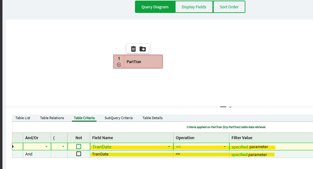

The key is to set subquery criteria using the from and to parameter. I knew this when I originally did it 4 years ago, but spent a half hour digging through all the junk in my memory. :wink:
You need to add criteria to restrict the results by you parameters:
