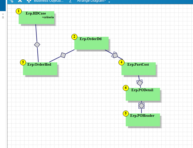

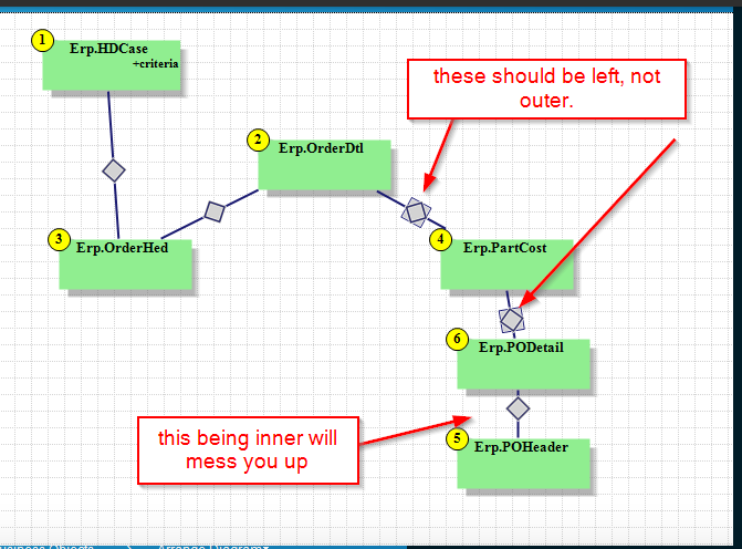

The other the joins on your query are a bit odd. See the screen shot.

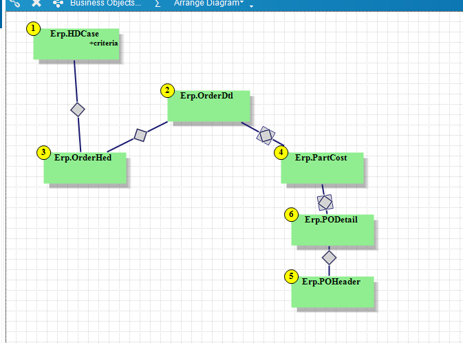

Also, would the joins look better like this then?

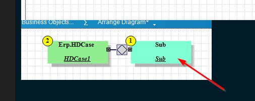

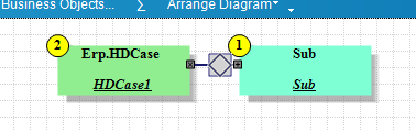

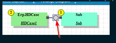

And is this fine where I connect the sub to my main query with HDCaseNum?
You want left joins. Outer join will show all on both sides of the table. You don’t want that. So on both places that I can see them in your screen shots, change them to left join.

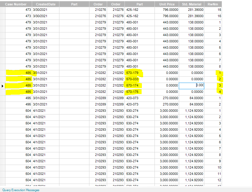

My bad I was trying to find the differences between this query and the old summary query. Not sure if this is the only issue, but it is ranking different part numbers within the same part 1,2,3,4 instead of 1,1,1,1 in the same case.
I’m assuming this just has something to do with my calculated row number being messed up but I am not very good at the SQL side of things. Essentially every part should for sure have a row number 1. If there is multiple PO’s…it should grab the closest date to the creation date of the case, make it 1, and then rank every PO after that 2,3,4 etc. This should be per-case, so if a part number shows up over multiple cases it should start the rank at 1 again.

Also, were do you have the filter display only 1’s. I would expect to see a filter on this table/sub-query, but there isn’t one.
The filter is in the linkage between HDCase1 and Sub. It just filters to Sub_RwNm = 1.
I do have the case numbers in the results, I just couldn’t show all the columns in that screenshot. Maybe this can show better what I mean?
And maybe it has something to do with the fact that there’s no PO for that part? Even still it should give them all a 1.

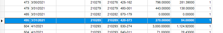

I had removed it to be able to diagnose and show the other RwNm’s to see what was wrong. But thanks for the advice also, I moved it to table criteria…
And when I add the criteria back it filters down to 1 like it is supposed too…the only issue is that it cuts my results short and doesn’t show my other part numbers in cases, like case 485.

You’re right, I think I needed to partition by PartCost.PartNum and no PODetail or HDCase.
I’m at 1326 results now and that’s a lot closer to my original BAQ than before. I think the 4 number difference in results is just due to the fact that we have some cases with duplicate part entries and I cannot think of a way to make those stay in. However, I do not think it becomes that big of an issue.
