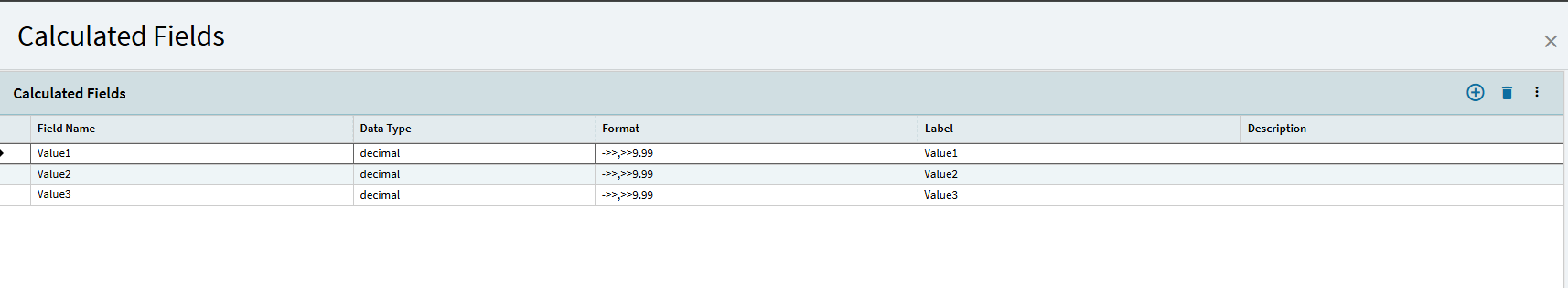

I wanted to change the label column from above image dynamically
I want to access Table2.Name and assign that name ,Instead of value1
There is not any way to dynamically assign labels in a BAQ that I know of.
